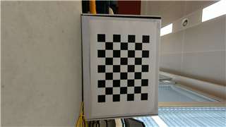

I have followed Matlab code given in [FAQ] TDA4VM: How to create a LDC mesh LUT for fisheye distortion correction on TDA4? - Processors forum - Processors - TI E2E support forums (in python) to generate bin file.
With my camera parameters and transformation matrix.
pitch_in_mm= 0.003
f_in_mm= 3.0
w= 1920
h= 1080
s=2
m=4
tr_front = np.array([[1.29623404e+00, -3.33760860e-01, 0],
                 [3.44805409e-02, 2.91188168e+00, 0],
                 [1.24291410e-04, -1.15834076e-04, 1.00000000e+00]])
I get correct undistorted image. It is looking correct.

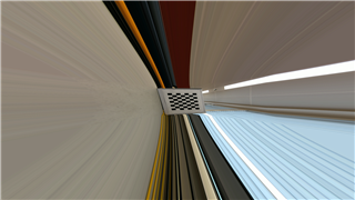

But when I multiply transformation matrix (tr_front) with xt, yt, zt. I get following image

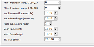

My setting in DCC tool file is looking like this
I have tried changing the values of 'm', it does not seem to make any difference. But when I reduce the value of 's' to 0.39 I get a zoomed in image.
I have also tried changing SL2 Size (bytes) value to 30,000. But it is also not making any difference.
Can you please tell me, what am I doing wrong here?

  • Hi Vivek,
    Do you mean you get the correct output image in matlab or somewhere in your python code?
    Could you please show how you applied the matrix in matlab code?
    It looks like this is what you get in tuning tool with your mesh LUT from matlab.
    It mean that your perspective transform is not done properly in matlab code.
    Yes, m is for down-sampling the mesh LUT.
    It does not change the mapping.

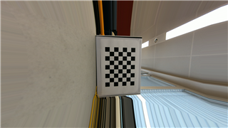

    Yes, "s" is part of the perspective change (zooming factor) and it will change your output image.
    This is for H/W cache size for LDC output buffering and it does not change your output image.
  • Hello Gang Hua,
    Thank you very much for your quick response.
    All the pictures I have sent you are the output of DCC tool.
    Here is my python code, where I applied matrix transformation.

  • Hi Vivek,
    I cannot tell for sure what is really wrong.
    Most likely, it is a difference between the (x,y) coordinate range in your python code and matlab.
    If you have everything working in python, we can get the input image coordinates in python.
    Then, you may simple create the mesh LUT in python following the matlab code for mesh LUT encoding and down-sampling.

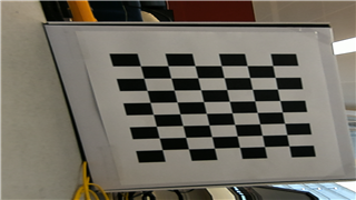

    I am still getting following image
    output
    Thank you
  • Hi Vivek,
    However, when I tried using the file in the DCC tool and added a transformation matrix, it stopped working.
    Do you use the matrix in LDC H/W or simply adding perspective change into the mesh LUT?
    My image size is too big (~267mb).
    VPAC image size is limited to 4K and that is about 12MB for 8MP.
    How do you get a LDC input image for 267MB?
  • I am still getting following image
    Your output view is still too large.
    You may think of "s" as part of the projective transform, i.e., a scaling factor.

  • OK, but if I manipulate 's' value, then it is also cropping the image from all the size. So I am losing visual information from left and right sides.  If try to get full view of the camera, then I get distortion (that stretch lines) on top and on bottom of the image. I have to do this FOV compromise ?
  • If try to get full view of the camera, then I get distortion (that stretch lines) on top and on bottom of the image.
    I am not sure if I understand you correctly.
    Do you have a fisheye lens or wide FOV lens?
    Correcting distortion will always loose some FOV.
