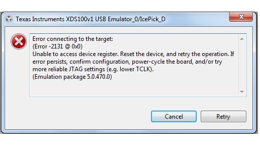

  • Dear Arun,
    I tried like what you said.
    and i got this error....
  • Did you try power cycling the board and connect again. This should work. Do you have any external JTAG connected too. The internal will not work, even you have a cable connected in the external JTAG pin.
    Arun.
  • Dear Arun,
    How to do the power cycling?
    An XDS560V2 emulator which came attached with the board is there.
  • I meant switching it off and on again.
    Arun.
  • Dear Arun,
     Power cycling was done already. It did'nt work. What else could be the problem?
