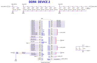

I'm having trouble debugging the DDR4 initialization on my AM6442 custom board, which is a whole new design and does not boot up successfully, yet.
Could you provide some guidance to help me to solve this issue? Thanks.

    1. Reference Design: TMDS64GPEVM
    2. Data Bus Width (per device): 8
    3. Density (per device) (Gb): 8
- Schematic (DDR interface from processor to memory)
  • This is the current status. Please for your information.

  • Hi JDA,
    the changes you made to the configuration look correct.

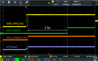

    One thing i noticed on the schematic is that DDR_RESETn should be pulled low thru a resistor (see page 9 of the DDR datasheet).  This signal should be low during power ramp, and the pull resistor low will ensure this.  I'm not sure if this is the main problem, but please try to correct this on one of your boards.
    Check RESET vs CKE on a scope.  CKE should go high at least 500ns after RESET goes high.  This ensures the initialization starts correctly.

  • Hi James,
    We've followed your guidance to modify our schematic. Now, the DDR_RESETn is pulled low through a resistor.
    After checking the DDR_RESETn vs DDR_CKE signal on a scope, the sequence seems not to be as expected. (page 9,10 of DDR datasheet)
    CKE goes to be HIGH firstly. After about 2.5 seconds, DDR_RESETn goes to be HIGH then.
    Do you have any idea about the possible reason of this unexpected result? Is it because of the DDR configuration of .dtsi?

  • Yes, the relationship between CKE and RESET is not correct.  But i'm trying to understand the scale you have setup on your scope.  RESET should rise to 1.2V, but i only see it go to less than 500mV.  CKE is VTT terminated, so its level is ok (although i can't explain the slight glitch before it goes high).
    Please double check the rework on RESET signal.  And take a wider scope shot, you should see RESET low during power ramp, and then transition to 1.2V once and stay high
    James

  • The regdumps are showing that the training isn't working at all, most likely indicating that something is wrong early on.  Certainly the CKE/RESET relationship is wrong, but that may be caused by something else, since that is a very fixed part of the hardware sequencing.  Please check the basics:
    -ensure all DDR voltage rails are at the correct level and stable before RESET  and CKE go high:
    Processor voltage rails:
    VDDS_DDR = VDDS_DDR_C = 1.2V
    VDDA_PLL1 = 1.8V
    VDD_CORE = 0.75 or 0.85V
    Memory voltage rails:
    VTT = 0.6V
    DDR_VREFCA = 0.6V
    DDR_VPP = 2.5V
    you can check others, but these are the main ones associated with the DDR.
    -probe DDR_CK to see if it is 800MHz
    James
  • Hi James,
    By following your kind advice, we've fixed some hardware issues and ensured each voltage rails are at correct levels as you reminded, respectively.
    You may check their status as below. Meanwhile, the new log content is also attached here.
    • If it is possible, could you review the new log for us?
    • Does the log mean our DDR initialization come to ready and work well? Which log message is your key identifier?
    • In addition, the boot process stops at the following point. Could you provide us further guidance, if you may? (Which stages has our boot process passed? At which stage our boot process currently stuck? Is it possible to do the memory test at current status?)
      • [   12.014182] platform fixed-regulator-sd: deferred probe pending
    PS: Thanks for being with us with patience as we improve our AM6442 custom board, recently.
