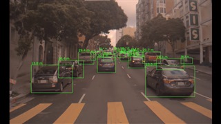

    Able to get the distance display on monitor, but the size is too large and coordinates are not correct.
    Is there any API I'm missing that to be added? Also, I have tried changing value of  this parameter sDist.fontIdx = 12; the font appeared to be decreased when modified the value but clarity of number(distance) is missing. Later included Draw2D_getFontProperty(&sDist, &fontProp); function,still no change in behaviour.
    Kindly let me know what causing this behaviour.

  • Hi Nikhil,
    I have tried changing the gDraw2D_Font_CharHeight, gDraw2D_Font_CharWidth parameters but the application wasn't working as expected.
    Please find the attached video references for the description of my concern.
    gDraw2D_Font_CharWidth     = 15; gDraw2D_Font_CharHeight    = 25; These are the default values came with SDK. With these, it is giving proper display output but a little large in size. While trying to modify the value as shown below.
    1) gDraw2D_Font_CharWidth = 14;  gDraw2D_Font_CharHeight = 25;
    The output is as shown below
    2) gDraw2D_Font_CharWidth = 15;  gDraw2D_Font_CharHeight = 10;
    Is the values can't be reduced further from the one given by SDK? Because when I have changed height from 25 to 20 it worked fine, but further reduction behaved as shown in video. And in width case even from 15 to 14, it behaved unexpected manner.
    Kindly comment on this and let me know how to proceed from here.

  • Hi Nikhil,
    As per your suggestion modified the code. Please find the attached code snippet for the same.

    With the above snippet the output is as in shown attachment.
    The font size increased more, and right half of utilization cores display part also changed to green color in between the run.
    Chaitanya Prakash Uppala
