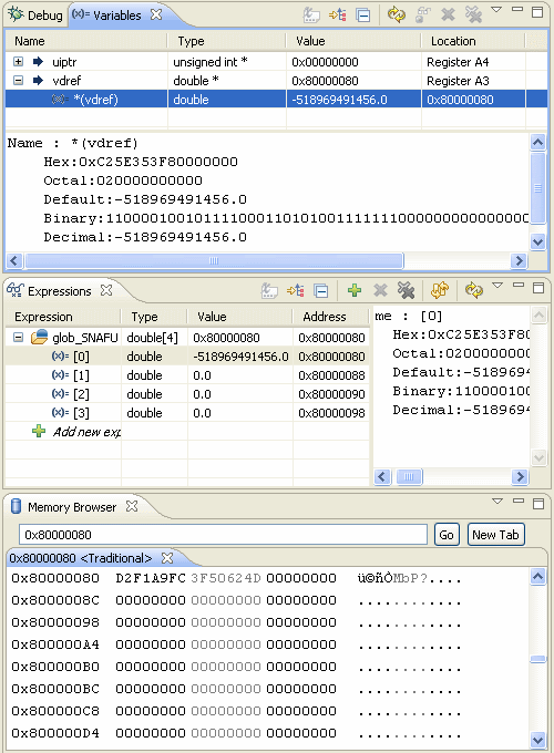

When I execute project on the hardware using debug mode of CCS via Blackhawk XDS560v2-USB Mezzanine Emulator and view the contents of glob_SNAFU[0], it's value at the end of execution is -518969491456.0 rather than expected 0.001. I currenly run it only on a single core. Both projects have the same sections included in the linker command file. The only difference being that the linker command file of the second project explicitly includes the .out file of the first project. Note: earlier attempts with integers and pointers resulted in correct values being assigned.

  • Found the problem.
    The value is only displayed wrong in Variables and Expressions views of the debugger. When the same spot in the memory is viewed through the memory browser it shows the correct value (in hexadecimal though, so it wasn't immediately obvious).
    I'm not sure this gives me much confidence in the debugger though.
  • Well, that's good to know that it's not incorrect.
    When you debug code that was built with optimizations, it's hard to replicate values exactly (that's why "Debug" is "Debug"!).  In my experience, when any of your values are stored in named registers in the variable monitor, then stepping through the code doesn't match what your original source code dictates.  For example, the final value may still be waiting until after the infinite loop to be written back.
    Summary: when you build with optimizations, don't expect debugging tools to work exactly.
  • This code wasn't built with optimizations (I explicitly specified -O0 to be sure that no optimizations would be present in the code), as I'm fully aware that once optimizations are used then the assembly won't match the c code line-to-line. I'm still not certain what causes this behaviour in the debugger. The problem persists when switching to non-volatile doubles.
