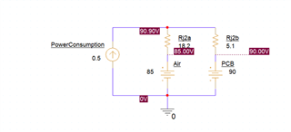

Considering I will qualify my design for up to 85 °C when using AM625P.
How do I have to calculate the junction temperature ?
Are my assumptions correct that there will be 2 parallel thermal resistances (Rjunction to board + Rjunction to air)
so that the following simulation correct ?
