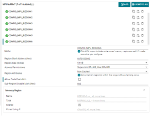

  • Hi Amey,
    1. How do I configure the M4 core to use the same shared memory? What configuration do I have to do in .syscfg file?
    To make M4 access the same shared memory, M4 project should have the MPU region defined in sysconfig and having access to the shared memory location. It would be better to add M4 project as part of the system project. You can refer to the IPC_notify_echo or IPC_rpmsg_echo message in the SDK to understand how M4 is added as part of the system project.
    How do I share a larger memory chunk say an array of 8 (4 bytes each)?
    Similar to how we define a variable to shared memory section, you can define an array similarly as well:

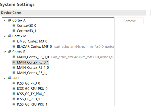

  • Hi Nitika
    Thanks for the sharing the link.
    I am trying out following scenario and facing an issue where data is not being shared between the cores:
    I want to transfer the data coming from UART of M4 core to be sent to UART of R50_0 core (single direction only for now). So I believe spinlock is not needed as whenever the value changes I am printing it in R50_0 core.
    I am using the empty example system project and replaced the default project with UART echo example for R50_0 and M4 cores.
    Other cores are not used hence the project linked to those cores are removed from system project. So now system project has two project (See below)

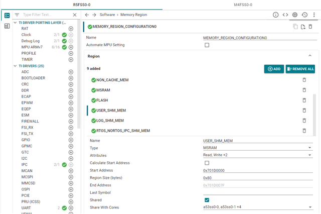

    In the example.syscfg of R50_0 core, I have shared the memory. See the screenshot below.
    Also in the syscfg of M4 core, access to MRAM is added.
    IPC is added to ensure all cores will start together. I have added IpcNotify_syncAll(SystemP_WAIT_FOREVER); at the begining
    of the examples and all cores start together.
    But when I try to run, I see that even the M4 core is placing the data in the shared memory, the same is not seen by R50_0 core. When I used breakpoints, the variable gSharedMem is still 0. But the variable gSharedMem  in M4 core has the value.
    Am I missing any configuration, because of which the memory is not getting shared, but instead they are treated like two independent global variables?

    I did not go through the UART implementation in your code, but I used the empty system project to implement the shared memory spinlock and it is working for me.
    One thing that I suspect could be going wrong in your implementation is the shared memory MPU region could be marked as 'cached'. This would result in the core reading a stale value and updating the same which is why the update from both the cores is not reflecting.
    In your project, if not defined please add the below MPU region corresponding to the shared memory marked as 'non-cached'.
    Do let me know if this helps.

  • Hello Nitika
    Adding a MPU region in the solution helped and now I am able to share the memory between the cores.
    I have added the MPU region in the example.syscfg file of R50_0 project only. I believe that is enough or do I have to also add the same in M4 configuration?
    Why is the address for shared region starting at 0x701D0000? Is the top end of MSRAM?

  • Hi Amey,
    Adding the memory region in the R5F0_0 project is enough when working with just one R5 and one M4 core.
    No, we have 2MB of On-chip RAM starting from 0x70000000, you can read about the memory layout of the MSRAM here - Memory_map_AM64x
