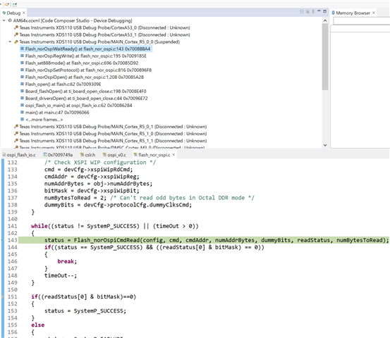

    I have tried symbol loading for user applications at startup.
    It appears that the following while loop is waiting in the Flash_norOspiWaitReady function in the flash_nor_ospi.c file
        while((status != SystemP_SUCCESS) || (timeOut > 0))
            status = Flash_norOspiCmdRead(config, cmd, cmdAddr, numAddrBytes, dummyBits, readStatus, numBytesToRead);
            if((status == SystemP_SUCCESS) && ((readStatus[0] & bitMask) == 0))
                break;
            timeOut--;
    What does this mean? Please suggest how to solve it.
    Kiyomasa Imaizumi.
  • Hello Kiyomasa,
    Do you mean the ospi_flash_io is running successfully but most of the time is taken by this while loop in Flash_norOspiWaitReady function?
    Prashant
  • Hello Prashant Shivhare.
    That's right.
    The ospi_flash_io is running.
    In the Flash_norOspiWaitReady function, timeOut is 0 and the status is SystemP_FAILURE.
    Function call order.
    Flash_open
    	Flash_norOspiOpen
    		OSPI_getHandle
    		OSPI_configResetPin
    		OSPI_setCmdExtType
    		Flash_norOspiSetProtocol
    			Flash_setOeBit
    			Flash_set888mode
    				Flash_norOspiRegRead
    				Flash_norOspiRegWrite
    					Flash_norOspiWaitReady --> Waiting for a long time.
    Kiyomasa Imaizumi.
  • Hello Kiyomasa,
    In this case, the example should not run successfully at all.
    I guess the SBL OSPI already initializes the OSPI in 8d-8d-8d mode so it fails when the application tries to do it. However, the R/W test still passes successfully because the OSPI was in initialized state by SBL OSPI.
    Can you please try the following patch for SBL OSPI to close the driver and power off the OSPI.
    diff --git a/examples/drivers/boot/sbl_ospi/am64x-evm/r5fss0-0_nortos/main.c b/examples/drivers/boot/sbl_ospi/am64x-evm/r5fss0-0_nortos/main.c
    index 7a52d3c4..ce33fa34 100644
    --- a/examples/drivers/boot/sbl_ospi/am64x-evm/r5fss0-0_nortos/main.c
    +++ b/examples/drivers/boot/sbl_ospi/am64x-evm/r5fss0-0_nortos/main.c
    @@ -273,6 +273,16 @@ int main(void)
                         status = Bootloader_rprcImageLoad(bootHandle, &bootImageInfo.cpuInfo[CSL_CORE_ID_R5FSS0_0]);
    +                Drivers_ospiClose();
    +                DebugP_log("[SBL] OSPI driver closed\r\n");
    +                SOC_moduleClockEnable(TISCI_DEV_FSS0_OSPI_0, 0);
    +                SOC_moduleClockEnable(TISCI_DEV_FSS0_FSAS_0, 0);
    +                SOC_moduleClockEnable(TISCI_DEV_FSS0, 0);
    +                DebugP_log("[SBL] OSPI devices powered off\r\n\r\n");
                     status = Bootloader_runSelfCpu(bootHandle, &bootImageInfo);
                 /* it should not return here, if it does, then there was some error */

    [2024-06-13 15:51:24.486] Start_01
    [2024-06-13 15:57:35.621] Starting ospi_flash_io example tests...
    [2024-06-13 15:57:36.240] All tests have passed!!
    But the situation did not change.
    It continues waiting in the while loop below.
    Kiyomasa Imaizumi

  • Hello Kiyomasa,
    Have you correctly integrated the flash configurations in the ospi_flash_io application?
    Maybe you can share the Sysconfig generated files for both sbl_ospi and ospi_flash_io application for comparison purposes.
    Prashant
