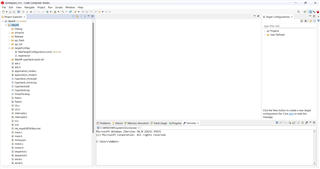

    Can you provide a screenshot of the entire CCS IDE when this happens?

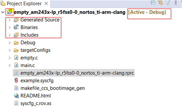

  • The project looks odd in Project Explorer. It is missing some things that indicate to me that this is a CCS project:
    Can you zip up the project folder and share it with me? Or at the very least just the three .*project files in the project folder.
    ki
  • Just checked and those files seem to be missing from the CCS project in the workspace- but they are present in the folder that was imported. Is there a reason it's not being included in the import?

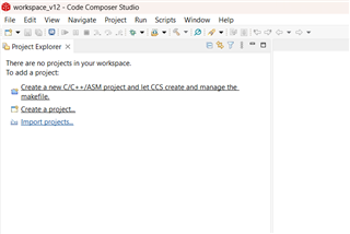

  • I've just tried a few different options after this question and have found that one of my projects will open correctly ( and can be built ) when I used the import option "CCS Projects" under "c/c++" shown below, but when I try "CCS Projects" under "Code Composer Studio", I get the error "See details below...
    Import failed for project 'project name' because its meta-data cannot be interpreted. Please contact support.
    That is odd. Both methods should do the same thing. What about when you do "Project -> Import CCS Project" from the main menu?
    Can you share the project or the three .*project metadata files?
  • I've tried repeating the process several times with fresh workspaces, but it consistently works on the "C/C++" but not the "Code Composer Studio" options. This is process is through the main menu, as in starting with toolbar - file - import - import wizard
    I've also tried the route highlighted in the screenshot below, but this shows the same error message
