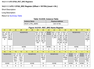

I want to find our the reset source of our board, Based on the datasheet, the reset sources can be got from CTRLMMR_RST_CTRL or CTRLMMR_MCU_RST_CTRL registers, but there are also two problems:
  1. No information about the memory map or address of  CTRLMMR_RST_CTRL or CTRLMMR_MCU_RST_CTRL registers in datasheet
  2. No detailed information of CTRLMMR_RST_CTRL or CTRLMMR_MCU_RST_CTRL  registers in datasheet
Could you give some information, Thanks.
