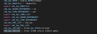

The picture above shows MCAL's makefile file about CDDIPC moudle.And version is 24.0.0。

Which MCAL SDK are you using? Between which cores are you trying to communicate using Cdd Ipc?

SDK version:mcu_plus_sdk_am62ax_09_02_00_38, We want the MCU DM A53 core to do the ipc communication.
The current MCAL SDK only shows communication between MCU R5 and A53 cores. The example showing IPC between MCU R5 and DM R5 will be coming in 10.0 MCAL SDK which is scheduled for July 2024. Even though there's no example, the driver should still support it.
The DM R5 A53 communication is supported by the MCU+SDK. You can take a look at the ipc_rpmsg_echo_linux example in MCU+SDK for reference.

The current MCAL SDK only shows communication between MCU R5 and A53 cores,Can you please release this MCAL package to us?MCU R5 and DM R5 will be coming in 10.0 MCAL SDK which is scheduled for July 2024,What is the specific date of July?

Using the latest MCAL, it was found that the CddIpcRProcLinux routine cannot run and has been waiting at Ipc_isRemote Ready. We confirm that Linux routines can support validation.
