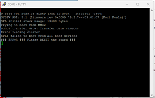

To do the ethernet testing, we want to try to boot from the SD card to do it. Right now I have the "tisdk-default-image-am62xx-lp-evm.wic.xz" image on it and I modified the DDR file in UBOOT so that would match our board.
Can you tell me what might be stopping the boot process based on the output below? Our design doesn't have OSPI but we can add it. Is there a set of config files (*.dts and *.dtsi) that would allow me to boot with only USB and 2 Ethernet?
This question requires another expert on the team to help you, the best way to get a hold of the expert(s) is to create a separate E2E post on this issue

I am not sure what to ask as the thread has a couple sub threads in it.
- One suggestion is keep working on the TI-EVM to practice reducing the peripherals not needed to get to the DTS file you want before moving to your board. To answer your earlier question the board DTS files are specific to u-boot and the kernel so each would need to be modified.
- Since you are seeing a SCHCI timeout in the console capture could mean several things.
Overall this thread will need to be split as Daolin mentioned. Right now this thread is in the networking support group, general u-boot porting is handled by another engineer. I will pass the thread tomorrow.
