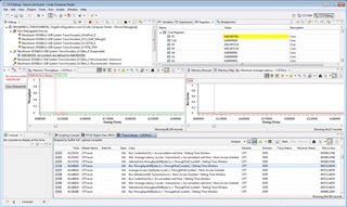

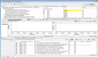

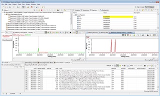

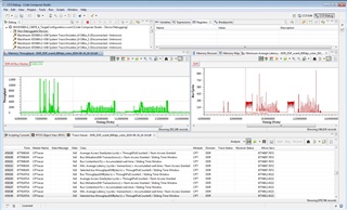

I am having trouble running Hardware System Trace on our custom target h/w to perform various hardware analyses, e.g. "Memory Throughput Analysis", etc.
I have a custom target system that has 4 C6678s.
I have created a Target Configuration as follows using the BHUSB56v2 System Trace connecting to 4 C6678s in the same JTAG scan chain of our custom h/w.
Using this Target Configuration I can successfully connect and run source level debugging on all 4 C6678 DSPs and each of their 8 cores, i.e. all 32 cores.

I have successfully used this Target Configuration for source-level debugging with the following
CCS v5.5.0,
Blackhawk Emulators 5.5.0.100,
TI Emulators 6.0.14.5,
Trace Analyzer 3.5.0.201309051307
CCS v8.3.1,
Blackhawk CCSv6.2 Emulation Update 6.2.0.011,
TI Emulators 8.4.0.0006,
TI Emulators Plugin 1.1.0.201909061315,
Trace Analyzer 4.1.0.201810301124
This Target Configuration successfully passes the Test Connection with the following report.
Same pass using either CCS v5.5.0 or CCS v8.3.1

    I Launched this newly created Target Configuration "BHUSB560v2_TMDXEVM6678L_TargetConfiguration.ccxml" on CCS v5.5.0.
    The Debug view showed the single C6678 and it's 7 C66xx's (C66xx_0 ... 7)
    I added "show al cores" and connected to them.
    I connected to C66xx_0 and did not load any project code and resumed running whatever was loaded on that core.
    I then selected "Tools\Hardware Trace Analyzer\Memory Throughput and Access Analysis" selecting Transfer Type ETB with advanced settings of Transaction Masters ... C66xx0-7, EDMA, PCIe
    The Trace Viewer showed data collection actively taking place.
    I then suspended C66xx_0 and Trace information populated within the "Trace Viewer - CSSTM_0" along with info being shown within both "Memory Throughput - CSSTM_0" and "Minimum Average Latency - CSSTM_0" tabs
    This is not all that impressive, but it does show that the EVM with BHUSB560v2 System Trace emulator can collect device information via ETB.
    Then I ran "Tools\Hardware Trace Analyzer\Memory Throughput and Access Analysis" selecting Transfer Type "560 v2 Trace" and after a 10-15 seconds of a calibration popup window being displayed it actually showed Trace information being displayed as follows.
    Run #1...
    Run #2...
    This suggests that the issue with performing hardware trace/info data gathering via CCS v5.5.0 or CCS v8.3.1 and "BHUSB560v2 System Trace emulator" regardless of Transfer Type ETB or 560 V2 Trace is localized to our "custom" h/w having 4-C6678s and/or how we are configuring/conditioning the EMU pins and/or clocking/timing setup.

    With this modification to use just to a single device we can connect to C6678_0 and perform h/w trace and inspect DDR3 Memory Bandwidth consumption on that device.
    Here's a trace snapshot of a Memory Throughput & Latency Trace capture that we can now get...
    I have a few questions regarding this output.
    1. Several DDR3 masters were selected in the advanced settings, i.e. C66x_0-7, EDMA, PCIe, but these are not presented in the legend as selectable by Memory Throughput nor Minimum Average Latency graphs.  We would like to gain insight into how much of the memory bandwidth is being consumed by which masters.  How can we get these various masters to be shown and selectable within these graphs?
    2.  The horizontal axis shows Timing (Ticks).  Is this in terms of the DSP clock cycles (1.25 GHz) or is this in terms of DDR3 clock cycles (667 Mhz)? What does Timing (Ticks) mean?

    [CCS Engineering] If they are not in the graphs then no data was collected for those masters. It could be that there were non transaction in the time window data was collected.
    [CCS Engineering] This is the bus clock.
