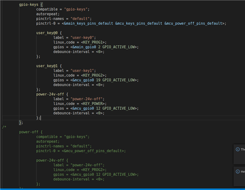

The device tree is configured as follows. The event driver does not fire any events.What is the possible reason?
thanks

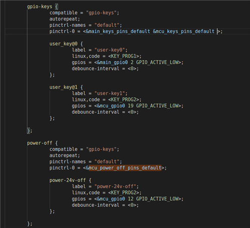

thanks
Can you check if you have
#include <dt-bindings/gpio/gpio.h> #include <dt-bindings/input/input.h>
added in the device tree?
Here are a few implementations in other device tree:
https://git.ti.com/cgit/ti-linux-kernel/ti-linux-kernel/tree/arch/arm64/boot/dts/ti/k3-am62x-sk-lpm-wkup-sources.dtso?h=ti-linux-6.1.y#n19
https://git.ti.com/cgit/ti-linux-kernel/ti-linux-kernel/tree/arch/arm64/boot/dts/ti/k3-am625-beagleplay.dts?h=ti-linux-6.1.y#n201
Non-AM62 devices:
https://git.ti.com/cgit/ti-linux-kernel/ti-linux-kernel/tree/arch/arm64/boot/dts/ti/k3-j721e-common-proc-board.dts?h=ti-linux-6.1.y#n22
https://git.ti.com/cgit/ti-linux-kernel/ti-linux-kernel/tree/arch/arm64/boot/dts/ti/k3-j721e-beagleboneai64.dts?h=ti-linux-6.1.y#n167
https://git.ti.com/cgit/ti-linux-kernel/ti-linux-kernel/tree/arch/arm64/boot/dts/ti/k3-am654-base-board.dts?h=ti-linux-6.1.y#n74

In this case, it is normal to trigger the event, I do not understand the difference between the two ways?
Can you clarify what you mean? Does this mean the event occurred successfully?
