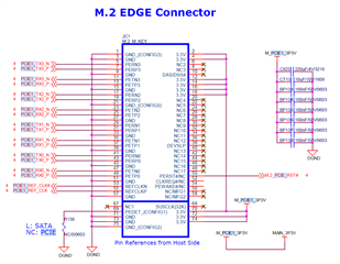

hi, experts
When I tried to connect an external pci device on M.2 M Key at SK-TDA4VM, kernel panic occurred.
Could you guide us what occurred the panic and how to fix it?
The pci device works up to 4 lanes.

  • What we connected on M.2 M Key slot is DeepX PCI-e card that has a single NPU and a single LPDDR5.
    They have two kinds of mode which are SATA and PCIE.
    There should be pulled up resistor on the host board side for operating PCIE mode so I installed pulled-up-resistor jumper at 69 pin on the SK-TDA4VM for now.
    what is the meaning of "the multiple functions" by the way?
    I don't think 69 pin affects kernel panic because when we connected Hailo PCIE card on the slot without the pull up jumper,
    it linked up anyway and scanned Hailo card well like the attachment of booting log of target board. (target board M key structure is exactly same as SK-TDA4VM's)
    Hailo
    hailo_linkup.txt
    DeepX

  • Does SK-TDA4VM automatically recognize a PCI device with 4 lanes?  Is there any additional configuration needed manually?
    Because Hailo module uses 2 lane max and DeepX module uses 4 lanes.
  • Hi Jaecheon,
    I was thinking this was the issue:
    https://e2e.ti.com/support/processors-group/processors/f/processors-forum/1264686/faq-j721exsomxevm-how-to-work-around-errata-i2086-for-pcie-switches-and-multifunction-devices-for-j721e-tda4vm-dra829
    Physical functions are a way to identify a PCIe device. Some device show up under the PCIe bus as multiple different devices. If you look at the lspci output section, this will give you an idea of what a device with multiple function looks like: https://software-dl.ti.com/jacinto7/esd/processor-sdk-linux-jacinto7/09_02_00_05/exports/docs/linux/Foundational_Components/Kernel/Kernel_Drivers/PCIe/PCIe_End_Point.html
    You can try putting the DeepX module on a x86 machine to see if it gets detected with lspci or other PCIe tools, and see if it enumerates multiple functions.
    Yes, SK-TDA4VM should automatically recognize a PCIe device with 4 lanes, 2 lanes, or 1 lane. No additional configuration needed. Depending on whether you are connecting to the E-Key or M.2-Key PCIe connector, it should negotiate for 1 lane or 2 lanes respectively, because PCie is backwards compatible with devices or connectors that support less lanes than its max capabilities.
    On the other hand, I looked through the logs and find that DeepX does not have a "Link up" log, nor do I see errors. Are there any modifications in the setup, hardware or software-wise, between the logs shared as M1_no_link.txt and your original logs that ends in a kernel panic?
    Takuma
