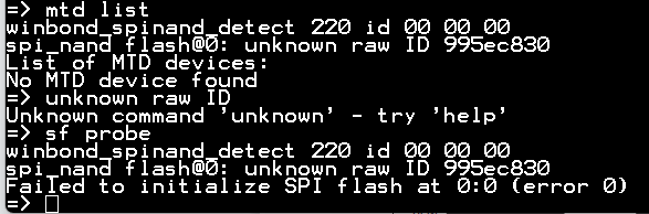

#1. What change needed to support a OSPI NAND flash? The SK board configuration based on OSPI NOR flash. Need a example.

on customer's board with upper configuration in SDK9.1. got below with mtd list"
#2. According to this post, need to modify source code to support a new OSPI NAND flash part number? How to adapt W35N04JWTBIF?
https://e2e.ti.com/support/processors-group/processors/f/processors-forum/1348933/am62a7-configure-ospi-nand-for-custom-board/
#3. There is not mtd command in my uboot, (SDK9.2), need specific configuration in uboot?
=> mtd list
Unknown command 'mtd' - try 'help'
#4. Is there difference between OSPI NOR and OSPI NAND to user? same command?
