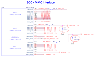

Dear Sir,
May I know what the purpose for the pull down R on MMC_CLK signal on TI EVM?

  • Most of the IOs associated with the AM62x device default to the off state, which means any attached device input without an internal pull resistor would be floating until software configures the pin to drive the signal. We use an external pull-down rather than an external pull-up since the clock signal is held in a low logic state when paused.
