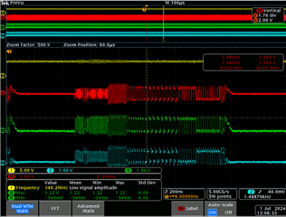

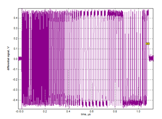

  • I'm checking by using an oscilloscope. Currently I'm having data like this.
  • By reference other processor than TI, I got some data like this in D+, D- line.
    This signal is what I expected in other processor than TI.
  • These signal are from usb2.0 port.

  • Hi CWL,
    Can you help to share the test waveform when using a differential probe? It should look something like this.
    Luis Parga

    Previously, I doesn't run Processor SDK Linux. I'm just using our developed software to alternate the value of register.
    Today, I had tried to do that with a SD card boot (image: tisdk-default-image-am62xx-evm.wic). I got the signal generated after follow the "devmem" steps as pictures below.
    So now, I have to figure out how can I achieve this without using the processor SDK linux in our software.
