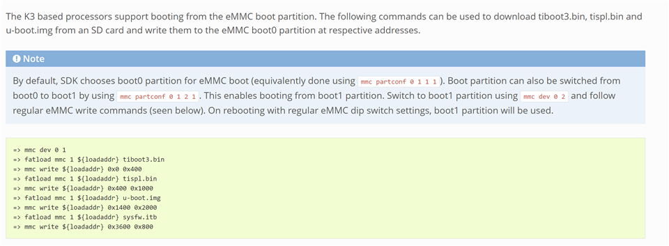

Flashing eMMC
Now I am trying to flash eMMC with tisdk-edgeai-image-j721e-evm.wic (which is successfully booted in SD card)
I used the following command to flash eMMC.
root@j721e-evm:~# dd if=tisdk-edgeai-image-j721e-evm.wic of=/dev/mmcblk0 status=progress
After successful flashing, I can see following partitions

The Problem
After this I rebooted, but the board is trying to boot from eMMC without changing and boot mode pins. Unfortunately, there is error in flashed build. In spl/dts/k3-j721e-sk.dtb, mmc0 is not defined probably.
So, board is struck at u-boot
Here is the log:
U-Boot SPL 2023.04-ti-gf9b966c67473 (Mar 19 2024 - 20:31:40 +0000)
SYSFW ABI: 3.1 (firmware rev 0x0009 '9.2.4--v09.02.04 (Kool Koala)')
EEPROM not available at 0x50, trying to read at 0x51
Reading on-board EEPROM at 0x51 failed -121
Trying to boot from MMC1
mmc_load_image_raw_sector: mmc block read error
Warning: Detected image signing certificate on GP device. Skipping certificate to prevent boot failure. This will fail if the image was also encrypted
Loading Environment from nowhere... OK
init_env from device 17 not supported!
Starting ATF on ARM64 core...
NOTICE:  BL31: v2.10.0(release):v2.10.0-367-g00f1ec6b87-dirty
NOTICE:  BL31: Built : 16:09:05, Feb  9 2024
I/TC:
I/TC: OP-TEE version: 4.1.0-51-g012cdca49 (gcc version 11.4.0 (GCC)) #1 Tue Jan 30 10:48:03 UTC 2024 aarch64
I/TC: WARNING: This OP-TEE configuration might be insecure!
I/TC: WARNING: Please check https://optee.readthedocs.io/en/latest/architecture/porting_guidelines.html
I/TC: Primary CPU initializing
I/TC: GIC redistributor base address not provided
I/TC: Assuming default GIC group status and modifier
I/TC: SYSFW ABI: 3.1 (firmware rev 0x0009 '9.2.4--v09.02.04 (Kool Koala)')
I/TC: HUK Initialized
I/TC: Activated SA2UL device
I/TC: Fixing SA2UL firewall owner for GP device
I/TC: Enabled firewalls for SA2UL TRNG device
I/TC: SA2UL TRNG initialized
I/TC: SA2UL Drivers initialized
I/TC: Primary CPU switching to normal world boot
MMC Device 0 not found
spl: could not find mmc device 0. error: -19
SPL: failed to boot from all boot devices
### ERROR ### Please RESET the board ###
Regardless of SD card present or not board tries to boot through eMMC only.
But as per my bootmode pins SD card(mmc1) should be the first.
I thought of changing mmcdev and bootpart in u-boot but the build failed before that.
