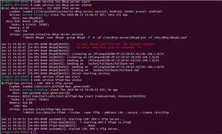

I've attached the dhcpd.conf file I'm using to research the Ethernet boot process.  I've installed the isc-dhcp-server on our native linux box that has a static IP of 102.168.1.41.  Have I correctly configured tthe server in the dhcpd.conf.  We want to target the IP range of 192.168.1.201 -192.168.1.220.

  • Hello Jim,
    I'm assuming the IP address you mean is 192.168.1.41 so that it is on the same subnet as the target IP range?
    Is there an issue you are seeing with the current dhcpd.conf configuration?
    -Daolin
  • Daolin,
         Yes, 192.168.1.41 is our Linux box.  We want the range to be 192.168.1.201 - 192.168.1.220.  If I start the dhcp server with "sudo service isc-dhcp-server start"  I don't see anything on Wireshark.  Is the config file set up correctly?  Also, I don't actually have any files for it to transfer, yet.  I wanted to see if there was anything on Wireshark first.  Do I need to start any other service on the Linux box?
  • Hi Jim,
    After running "sudo service isc-dhcp-server start" what do you see when you check the status of isc-dhcp-server, is it "active"?
    Also, do you have a tftp server setup on your Linux box as well?
    -Daolin
  • Hi Jim,
    Looks like the two services you need (isc-dhcp-server and tftp server) are actively running. Do you have your target board to boot from connected to your Linux PC via ethernet?
    -Daolin

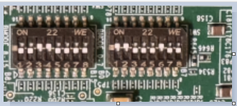

  • Are you testing on a custom board or AM62x SKEVM? If testing on the SKEVM, do you have the boot switches configured for Ethernet boot mode?
    -Daolin
  • I'm working on our custom board and it has similar "boot" switches.  I can configure the UART Boot and run SBL_UART successfully.  It initiallizes the processor so I can use CCS.  Since we don't have OSPI, I need to run the SBL_UART script each power cycle.  The design was complete before I started on the project.
    So I have it set for Ethernet boot.
    I have the equivalent of this setting on our custom board.

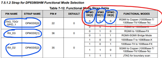

         We did need to make a hardware change to get the indicator LEDs functioning:
         I was not able to see BOOTP on Wireshark.  I monitored our network while doing the same thing on the development board and I didn't see BOOTP messages from the development board either (just setting DIP switches to ethernet boot).
           Any suggestions?
  • Since you are mentioning the PHY and are unsure of the board I will recommend a couple of preliminary steps.
    You need to prove that the PHY on the custom board is able to establish a link with a link partner. Try using the TI EVM as the link partner directly connected to your custom board, use the eth0 port. Then use ethtool eth0 to see if a link is established. The PHYs do this automatically without drivers needed to be loaded.
    If a link is established the next step I would recommend is connecting the custom board directly to the machine that has wireshark running on it, single cable no switches. I do not have a board at the moment, I will look tomorrow to confirm your switch settings.

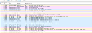

  • OK!  What output should I expect on Wireshark if I confirm a link with ethtool?
    Both ports are able to establish a link:
    Wireshark shows:
    What useful information is displayed (with no code on the processor)?

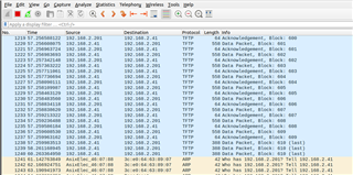

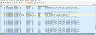

    Back to BOOTP...  I got the dhcp config file working but I get the following on Wireshark
    I'm not using UBOOT files built for the ethernet boot, yet.  I just wanted to be sure I was able to get the files using the server.  I've got files in both /tftpboot and /var/lib/tftpboot.
    One of the config files had the file location in another location.  After adjusting for that I got the following:
    I didn't see any additional file transferred and I'm using a tiboot3.bin from the standard TI image (it's not been built for the ethernet boot).  I don't see anything on the terminal when I cycle power.  Do I keep the DIP switches in the ethernet boot mode position?  Will I see anything if I don't use a tiboot3.bin file built for the ethernet boot?
    Moving forward...
    When I change the defconfig to ethboot, build u-boot from the top level "make u-boot) and move the three files ( tiboot3.bin, tispl.bin and u-boot.img) to the folder for the ethernet boot, I get the following:
    Right now I'm trying it on the development board so there should be no need for hardware changes.
    More...
    It looks like it sends tiboot3.bin again after I reset the development board and then the above text appears on the terminal.
