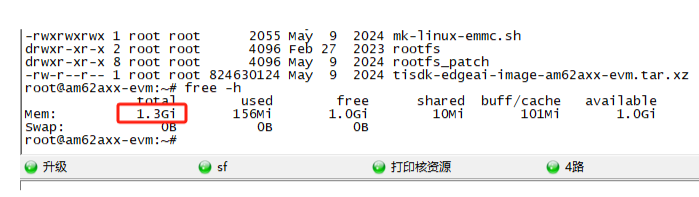

Hi teams:
sdk version:sdk 806
We have configured the memory from 4G to 2GB, but when there is no running memory after booting up, it shows that only 1.3GB is available, which is close to 700MB and missing. May I ask where this part is occupied

1:How to optimize and obtain as much available memory as possible
2:If optimization is not possible, is there any way to clearly know where this memory is being used

    EdgeAI node is almost 300MB..
    Suren
  • hi suren:
    I see,but 2.0G -300M = 1.7G, now is 1.3G on total,where is the 400M?
  • Hi Wu,
    Its edgeAI taking 300MB, but if you look at the reserved-memory, we are also reserving memory for the other cores.
    Have you modified the reserved memory and see any changes?
    Suren
  • May I ask which specific cores use 400M,
    Like the patch above, I did not modify the reserved memory section of DTS
  • Please add the details in the reserved memory and see if its more than 600MB in total, that should answer why you are seeing 1.3G of Free memory.
    Suren
  • My reserver memory debugging and printing information shows a total of 398M, which is approximately equivalent to 400M. 2G-400M=1.6G, and now it is 1.3G. Where did the other 300M go
    below:

  • Hi Wu,
    So based on your reserved memory of ~400 MB, used memory of 156MB and buff/cache of ~101MB, it totals to ~650MB so the total available shows up as 1.3GB.

  • Hi Wu,
    Line #114 in the attached dmesg.txt shows this:
    [    0.000000] Memory: 1137248K/2097148K available (11200K kernel code, 1162K rwdata, 4320K rodata, 1920K init, 431K bss, 755100K reserved, 204800K cma-reserved)
    Hope this helps.
    Suren
  • 2097148K-1920K-755100K=1340128K, with a difference of 3M, approaching 1343968K
    root@am62axx-evm:~# free -k
                  total        used        free      shared  buff/cache   available
    Mem:        1343968      155936     1086348       10800      101684     1060284
    Swap:             0           0           0
