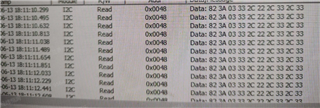

The attached picture is read from register 0x5A. You can see that the register becomes 0000 at the moment of power failure. After that, the read device ID also returns 0000, but ACK exists.
We read the 20byte value after 0x01 as follows, NVM version 03
