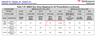

Hi TI experts,
HW: our custom board
SDK: j721s2, 8.6
When we configure the eMMC to DDR52 mode, MMCSD0_SS_PHY_CTRL_4_REG @ 0x04F8810C value is 0x0010600A, which indicates that the input delay is not enabled, which is inconsistent with datasheet Table 7-57. How to configure ITAPDLYENA for DDR52? Is there a patch for this?

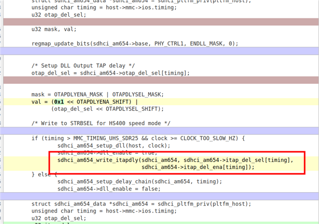

  • Hi quanfeng,
    Required changes are already taken care in the 6.1 kernel release, you can take a look into the patch.
    https://git.ti.com/cgit/ti-linux-kernel/ti-linux-kernel/commit/drivers/mmc/host/sdhci_am654.c?h=linux-6.1.y&id=3465401e7e594c3561e92bd775432d8287258e6b
    Diwakar
  • Hi Diwakar,
    When I use the sdhci_am654.c file from this commit, MMCSD0_SS_PHY_CTRL_4_REG @ 0x04F8810C value is 0x00106000, which indicates that the input delay is still not enabled.

  • Hi quanfeng
    Does this condition is not hitting?
    In the emmc driver code shown below, I found that only HS200 and HS400 can tune input delay, does this mean that DDR52 does not need to enable input delay? But in the datasheet DDR52 mode needs to enable input delay. which one is right?
    Tuning is only required for the HS200 and HS400 speed mode you can refer to the JEDEC v5.1 spec for the same.But we do set the value statically during the set clock function call for the other speed mode.
    Diwakar
  • Hi Diwakar,
    This condition is hitting, but the default itap_del_sel and itap_del_ena values are 0.
    The problem is that in DDR52 mode TDA4VL needs tuning, which is different from the JEDEC v5.1 spec
    When I add the following code to enable tuning, the kernel reports "No passing ITAPDLY, return 0" and fails to enable tuning.

    [    2.018822] fqf sdhci_am654_write_itapdly val 0x0010610a
    [    2.024236] fqf sdhci_am654_write_itapdly val 0x0010610b
    [    2.029617] fqf sdhci_am654_write_itapdly val 0x0010610c
    [    2.034989] fqf sdhci_am654_write_itapdly val 0x0010610d
    [    2.040376] fqf sdhci_am654_write_itapdly val 0x0010610e
    [    2.041422] ALSA device list:
    [    2.048690]   No soundcards found.
    [    2.048696] fqf sdhci_am654_write_itapdly val 0x0010610f
    [    2.057462] fqf sdhci_am654_write_itapdly val 0x00106110
    [    2.062864] fqf sdhci_am654_write_itapdly val 0x00106111
    [    2.068249] fqf sdhci_am654_write_itapdly val 0x00106112
    [    2.073626] fqf sdhci_am654_write_itapdly val 0x00106113
    [    2.079019] fqf sdhci_am654_write_itapdly val 0x00106114
    [    2.084429] fqf sdhci_am654_write_itapdly val 0x00106115
    [    2.089807] fqf sdhci_am654_write_itapdly val 0x00106116
    [    2.095182] fqf sdhci_am654_write_itapdly val 0x00106117
    [    2.100559] fqf sdhci_am654_write_itapdly val 0x00106118
    [    2.105954] fqf sdhci_am654_write_itapdly val 0x00106119
    [    2.111375] fqf sdhci_am654_write_itapdly val 0x0010611a
    [    2.116756] fqf sdhci_am654_write_itapdly val 0x0010611b
    [    2.122128] fqf sdhci_am654_write_itapdly val 0x0010611c
    [    2.127501] fqf sdhci_am654_write_itapdly val 0x0010611d
    [    2.132874] fqf sdhci_am654_write_itapdly val 0x0010611e
    [    2.138246] fqf sdhci_am654_write_itapdly val 0x0010611f
    [    2.143617] sdhci-am654 4f80000.mmc: No passing ITAPDLY, return 0
    [    2.149705] fqf sdhci_am654_write_itapdly val 0x00106100
    [    2.155265] mmc0: Command Queue Engine enabled
    [    2.159709] mmc0: new DDR MMC card at address 0001

  • HI quanfeng,
    You are getting 0 as you haven't added ti,itap-del-sel-ddr52 property under the emmc node.
    This is not correct, the tuning is not required for DDR52 mode, the value mentioned in the data manual is static and that can be configured using device tree by adding the property.
    No need to perform a tuning operation in the driver for the DDR52.
    Diwakar
  • Hi Diwakar,
    What is the value of the ti,itap-del-sel-ddr52 property of TDA4VL, I don't see a corresponding value in the datasheet.
    quanfeng
  • Hi quanfeng
    This seems incorrect in the data sheet
    ii am checking internally for the correct value, one more thing is that this is required to adjust the sampling clock are you seeing any issue with the DDR speed mode ?
    Diwakar
  • Hi Diwakar,
    Did you get any results?
    In DDR speed mode, the eMMC clock is a normal 50Mhz.
    quanfeng
  • Hi quanfeng
    Still waiting for response.
    If you are not facing any issue with the read/write , it is okay if you are not keeping the itap delay value for the DDR52.
    Diwakar
  • Hi quanfeng
    we got the update ITAPDLYSEL is 0x3 for DDR52 speed mode.
    Diwakar
