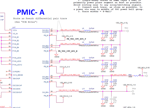

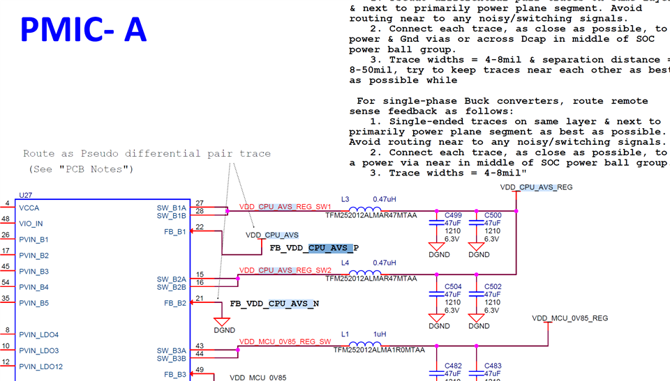

Hello experts,
When I introduced the PMIC nodes in the DTS I get an endless reboot loop. The log finishes with:
[ 2.564962] vdd_mcu_0v85: Bringing 3300000uV into 850000-850000uV
and then reboots.
Full boot log:

Looking at the schematics for PMIC-A, Buck 1, 2 and 3 are connected to build the VDD_CPU_AVS:
But in the dts, they are setup differently, with Buck12 together and Buck3 separate. See above.
Can this explain the behaviour?
/Bo
  • Update:
    I experimented with the pmic dts nodes and set them according to the schematic and the problem disappeared. This is the change (pseudo-diff):
    	tps659413: pmic@48 {
    		compatible = "ti,tps6594-q1";
    		reg = <0x48>;
    		system-power-controller;

    As you can see, I removed the vdd_ddr_1v1 node completely as it is not mentioned in the schematics for PMIC-A.
    Please review this change.

  • Hi Bo,
    I looked at the driver for tps6594x. For your schematics, the change you have done is correct.
    I believe the issue is now fixed and the changes look good. Closing this.

  • Hi Keerthy,
    I think it is worth to mention that the schematics above is the EVM schematics, so the
    update very much applies to the EVM dts as well. In fact I am suprised that the EVM
    platform does not show this reboot behaviour.
    /Bo
  • Bo,
    No. I am not sure where or which schematic your referred. I am checking the DRA829-EVM:
    I see the current DTS is right. No change needed.
    - Keerthy
  • Hi Keerthy,
    I see. I am looking at the PROC112E2(001)_SCH.pdf, which apparently has a different configuration.
    Thanks for the clarification.
    Since it appears that our HW has mimic'd the TDA4VM schematic that I pictured above, where can I find the corresponding dts for that configuration?
    /Bo
