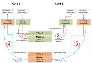

    I see that VRING is used. Do you have more detailed documentation on this?
    The concept of VRING memory is the same as mentioned in the PRU documentation. The different types of data stored in the VRING could be different in the case of PRU and ARM cores. If you are interested I can look into the VRING structure used in the case of PRU.
    On a very basic level, VRING is a shared memory segment, between a pair of CPUs, which holds the messages passed between the two CPUs. The sequence of events as a message is passed from a sender to receiver and back again is shown in below figure:
    The local structure to maintain state of a given VRING is as below (from ipc_rpmsg_priv.h)
    typedef struct
        uint16_t lastUsedIdx;            /* last read index into used Q */
        uint16_t lastAvailIdx;           /* last read index into avail Q */
        uint16_t vringNumBuf;            /* number of buffer in the vring */
        struct vring_desc  *desc;        /* pointer to buffer descriptors in VRING shared memory */
        struct vring_avail *avail;       /* pointer to avail Q in VRING shared memory */
        struct vring_used  *used;        /* pointer to used Q in VRING shared memory */
        uint8_t            *bufBaseAddr; /* pointer to message buffer 0 in VRING shared memory */
    } RPMessage_Vring;
    I do not think there is a documentation explaining VRING in great detail. I will look into it and share it with you if I find any.
