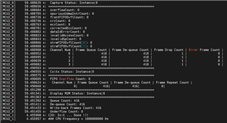

          Our camera demo is already running normally on our board based on the 8.6 SDK.  Now we plan to upgrade to the 9.2 SDK.
However, during debugging, we encountered an error message saying  'Incomplete Frame for Ch0-3'. Could you please tell us what might be causing this issue? The same demo works fine on the 8.6 SDK
test board: Custom board (works fine on 8.6sdk)
boot_mode: SBL HLOS boot
video_link: capture(uyvy) -> ldc(nv12) -> msc(nv12) -> m2m(rgba) -> csitx

  • Hi Tahm,
    This log was introduced in SDK 9.2 in vx_capture_target.c in the API tivxCaptureDequeueFrameFromDriver()
    This checks if your dequeued frame is a full frame or truncated frame and gives this log.
    This log / check was not present in SDK 8.6. Could you please add the highlighted code below in SDK 8.6 in tivxCaptureDequeueFrameFromDriver() and check if you are seeing this error?
    Nikhil
  • Hi, Nikhil,
    Thanks for your reply.
    1.  >>>> I can see this error on SDK 8.6, the graph is running, you can see frame rate in log file
    8.6sdk-capture-1280x720.txt
    2. Then I change the capture size to 1280x960, I can't see this error.

  • Hi, Nikhil,
    although there is no data can be dequed from capture node, the fvid driver can deque data
    MobaXterm_COM4ProlificPL2303GTUSBSerialCOMPortCOM42_20240619_151540.txt
    BRs,
    Tahm
  • Maybe your sensor is configured to output only 1280x960 image size and so when using 1280x720 image size in CSIRX, it is giving errors. Please check your sensor output and configure the same size in CSIRX.
    Brijesh
  • Hi, Brijesh,
    I have corrected the image size to 1280x960 on SDK 9.2. but can not dequed buffer from capture node.  I have show the log above, can you please help to check ?
    BRs,
    Tahm

  • Hi xie jc,
    Ideally, yes, please start a new thread for the new questions.
    Even your qneue/dequeue is working fine, because otherwise enqueu, dequeue and frame drop count in the above stats will not look correct.
    Brijesh
