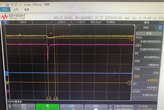

Further experiments:

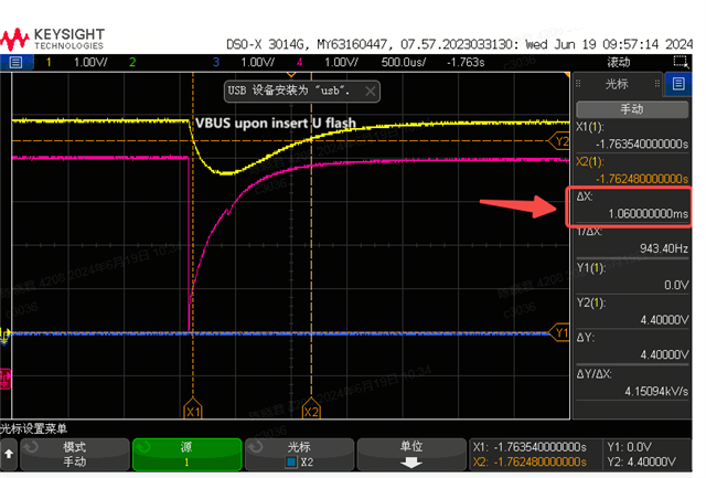

If keep VBUS=4.2V, insert/detach MSC U flash can always successful, but if has voltage drop during insertion even drop to 4.6V, also trigger VBUS error and result can't recover.
The Yellow line is VBUS, drop to 4.6V during inserting MSC U flash.

    Customer checked and there is no 120uF on board, which is indeed a design defect, but there are two questions that have not been explained clearly:
    (1) It can work normally at 4.2V, and it will also trigger an abnormality when it drops to 4.6V. What is the reason?
    (2) What is the trigger response time of this voltage drop? It can trigger an abnormality when it is less than 100us.

  • Hi, Bin
    Customer have add 120uF CAP on board but they can still see the error.
    They test 5V supply, and it can reproduce at a lower frequency.
    4.2V supply, test for hundreds time, can not reproduce the issue.

  • Hi Zekun,
    The USB Specification requires the USB devices should not have more than 10uF capacitance to prevent too much VBUS drop during insertion.
    I am a sw buy and don't know how to measure the capacitance of the USB device you use. But if you have the VBUS drop issue with multiple different USB devices, you might want to the check the power rail on your board to the VBUS power switch.
    Can we try to enable SOC to retry to connect to USB, not waiting all the time.
    If the VBUS drop issue is caused by device insertion in-rush current, retry in software won't be able to resolve the problem, since the VBUS will drop again after software tries to turn on the VBUS switch. You would have to figure out how to fix the problem in hardware.
