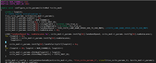

Now we are using SDK 9.0 on our customer board and we meet a problem when we try to use CSITX to output image.
This is the configuration of CSITX:

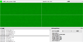

    the tivx_csitx_param_t  param in a more visible way:

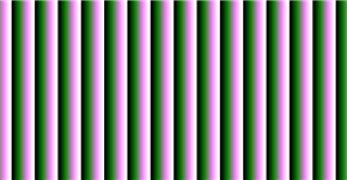

    and we want to transmit a image of 800x1280, UYVY.
    this is a sample of the transmitted image:
    and this is how it looks like on the receive side:
    apparently, they did not match.

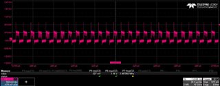

    problem may reside in multiple places. But at first, the MIPI signals transmitted by TDA4 seems not in a good state.
  • Hi all:
      Let me add the results of the hardware test. The MIPI-CSI tested so far has waveform output, but there is no high-frequency part in the waveform. The currently measured periodic waveform is about 1.8MHZ, which is similar to the Low Speed ​​mode of MIPI.
    This waveform is the current MIPI_CSI_TX, which is an abnormal waveform in comparison.
    If it is a normal MIPI waveform, there will be a clear contrast between Low Speed ​​and High Speed ​​modes, and high-frequency signals will also be significantly observed.
    This waveform is normal MIPI_CSI_RX.

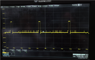

  • Hi Jadav
    We run the same application and use a 4GHZ differential probe to collect data.
    The yellow waveform in the oscilloscope is TDA4VM. It can be clearly seen that there are MIPI-Low Spped Mode and High Speed ​​Mode (differential signals of about 300mv), and the High Speed ​​mode has very dense data waveforms, which proves that data transmission is normal.
    The green waveform is TDA4VH, but when running the application on TDA4VH, although the MIPI-High Speed ​​mode can be seen, it is obvious that there are very few high-frequency signals, which seems to indicate that the data sent is abnormal and there is no very high-frequency waveform. We cannot receive valid images after converting MIPI-CSI to FPD LINK and then deserializing to DSI.

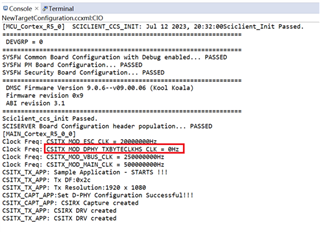

    This is the CCS output:
    We found that there is a line shows "CSITX_MOD_DPHY_TXBYTECLKHS_CLK = 0Hz". Is this right?
    How are you getting TX Byte clock? If it is enabled, it should not be set to 0x0. Can you please check and confirm that you are using standard SDK binary and there are no changes in the source code?

    I just compiled csitx_transmit_test, and then used CCS to put the xer5f file into mcu2_0 and run it.
    I haven't made any changes to the source code.
    ok, let me check it next week, my concert is tx byte clock, it should not be 0.

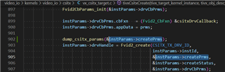

  • updates on this:
    We tried to run the pdk example, and the output waveform looks good. But tiovx app still outputs abnormal waveform.
    So I changed  my tiovx app to transmit the exactly same image format and size as it in the pdk demo. Still the tiovx app outputs abnormal waveform.
    I checked the csitx fvid2 create parameters, the two sides are exactly the same, both transmits 4 x 3840x2160 RAW12 images at csi lane speed TIVX-CSITX_LANE_BAND_SPEED_1600_TO_1800_MBPS.
    Then I checked the csitx related registers, this time I find some differences:

    Is the CSITX parameters setup correctly? Are you sure that the create parameters in both the cases are matching?
    Yes, I hexdumpped all the "InstParams->CreatePrms" before calling Fvid2_Create. they are exactly the same.

    [MCU_Cortex_R5_0]  SCICLIENT_CCS_INIT: Jul 12 2023, 20:32:00Sciclient_Init Passed.
     DEVGRP = 0
    SYSFW Common Board Configuration with Debug enabled... PASSED
    SYSFW PM Board Configuration... PASSED
    SYSFW Security Board Configuration... PASSED
     DMSC Firmware Version 9.0.6--v09.00.06 (Kool Koala)
     Firmware revision 0x9
     ABI revision 3.1
    Sciclient_ccs_init Passed.
    SCISERVER Board Configuration header population... PASSED
    [MAIN_Cortex_R5_0_0]
    Clock Freq: CSITX_MOD_ESC_CLK = 20000000Hz
    Clock Freq: CSITX_MOD_DPHY_TXBYTECLKHS_CLK = 0Hz
    Clock Freq: CSITX_MOD_VBUS_CLK = 250000000Hz
    Clock Freq: CSITX_MOD_MAIN_CLK = 500000000Hz
    CSITX_TX_APP: Sample Application - STARTS !!!

    this is my app, you can compile and run it on EVM board. It outputs 1 x 1920x1080 UYVY image at csi lane speed CSITX_LANE_BAND_SPEED_870_TO_950_MBPS .
    app_csitx.zip
    this is the image I received on my side using our product board, but it is apparently not correct.
    So I would like to see the image on EVM board on your side.
    It could not be better if you can check any mistake in my code.
    thank you very much
    But you are just storing incrementing data in the input frame in below function. The output will not be correct in this case. are you checking the pixel values in the receiving end?
    static void generate_frame_0(void *data_ptr, uint32_t width, uint32_t height)
    static uint32_t offset;
    uint8_t *addr = data_ptr;
    for (vx_size i = 0; i < image_byte_size; i++){
    *addr++ = (i + offset) & 0xFF;
    offset++;
    Brijesh
  • I have tried to check the image on send side, it looks like:
    So the received image is quite different from it on the send side.

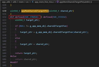

    I finally resolved this.
    Just one line code:
    The cause is the wrong memory address submitted to csitx_drv in the csitx target code. It should be physical address rather than target address.
    I checked the function tivxMemShared2TargetPtr, it finally goes to this function:
    On SOC J784S4, this function convert the ptr to another value, while on SOC J721E, it returns the original value of ptr. That is why my code can work well on j721e but not on j784s4.
    But, finally, one more question, why there is a convert of address on j784s4 but not on j721e?
  • Hi Haijun,
    oh, this issue is fixed in the latest release. In SDK9.2, i see we are using tivxMemShared2PhysPtr API to get the physical address of the buffer.
    This is required on J784s4 because the buffer memory is in high mem, so in order to make it accessible on R5F, RAT is used, but this RAT mapped memory cannot be used for DMA/CSITX. CSITX requires physical memory..
    Brijesh
  • Then why is RAT not needed for J721E?
    In other words, as far as the code is concerned, how to understand the macro #if and #else
  • Well, for J721E, its not required, because its one to one mapping and Frame buffer memory is stored within 32bit/4GB range.
    Brijesh
