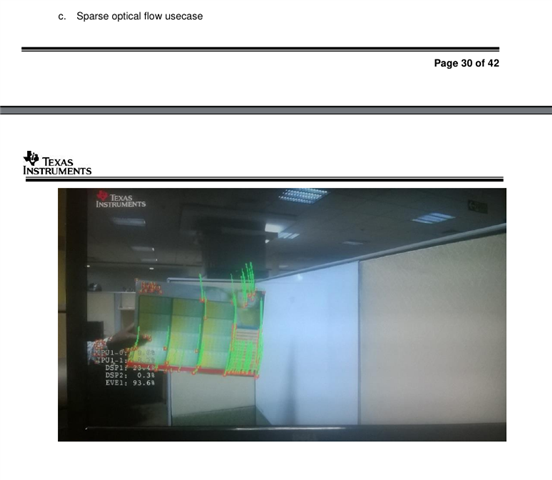

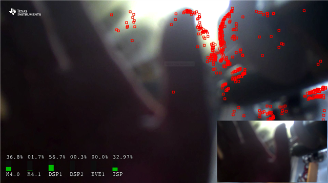

I'm running the latest PSDK Version: 03.08.00.00, Release date: 25 Dec 2019 using a TDA3X Board and a OV10640 CSI2 Cam. I've previously ran ISS usecases and I took the code from VIP Single Cam Edgedetect usecase and successfully integrated and adapted it to fit the usecase 1CH ISS capture + iss isp + iss ldc+vtnf + display. I wanted to do the same for sparse optical flow, and I got the following result: Interestingly enough, EVE load is 0, even though the rectangles are being drawn and it's part of the EVE part of the Algorithm.
I get the square detection, but no green lines indicating from which direction the object is coming from as you can see from the userguide, this is what should be showing:

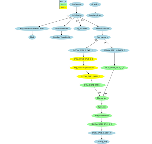

Here is the generated use case tree and my .c file which is based on the ISS use case, I integrated all the SOF functions from the VIP Single Cam Sparse optical flow. The code is from the 1CH ISS use case with the functions adapted and names changed to replace the ISS usecase in the start menu and not have to put my own anew. The autogenerated functions are also called, otherwise the usecase wouldn't be running in the first case. My suspicion is something going wrong in the Dup_capture link, as anything below that should be identical in my usecase the only thing changed is the capture input from VIP to ISS. I can't figure out why the lines aren't being drawn, it could also be the merge and sync algorithms...I've also disabled the SFM stuff, as it seems like it's only exclusive to VIP and I cannot use it, the SDK will not build properly as the input parameter expects a regular CaptureLink instead of ISS_Capture.
If anybody can run the VIP single cam SOF usecase just to check what the actual output is, I would also be very grateful to cross check what the expected output is instead of use the example TI provided in the picture.

I've also breakpointed my way through the draw library and saw how the 'drawlines and squares' functions were being triggered, so I was jumping into those, but I have the suspicion that the values are not properly passed during either dup_capture, sync or merge most likely. I also used the expressions tab during the draw process and saw how the X and Y coordinates are subtracted during the lines and they give 0, so it always subtracted the same value from itself, with the lines being 0.
  • UPDATE: I got it working, linePrm.lineSize = 2; needs to be used, originally  linePrm.lineSize = 1; was used, for some reason this doesn't work even though its the default configuration.
    Void AlgorithmLink_objectDrawSofFlows(AlgorithmLink_ObjectDrawObj *pObj)
        sofctr++;
        Draw2D_LinePrm rectLinePrm, linePrm;
        strackInfo * trackInfo;
        UInt16 vx, vy, xmin, xmax, ymin, ymax;
        UInt16 numLines, i, j, minPt, maxPt, idx, startX, startY;
        if(pObj->pSofOutput==NULL)
            return;
        trackInfo = pObj->pSofOutput;
        startX  = startY = SOF_ALGLINK_PAD_PIXELS;
        rectLinePrm.lineSize = 2;
        rectLinePrm.lineColor = COLOR_RED;
        rectLinePrm.lineColorFormat = SYSTEM_DF_YUV420SP_UV;
        linePrm.lineColor = COLOR_GREEN;
        linePrm.lineColorFormat = SYSTEM_DF_YUV420SP_UV;
