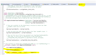

ClockP_usleep is a PMU (Performance Monitor unit) timer which runs at R5F core operating frequency. By using it also, we can derive the use delay, but this will not work correctly if any lower priority tasks execute WFI instructions, and it is used mostly in NORTOS applications.
For free RTOS applications, this PMU timer does not work out.
The below one is lowest priority task .
To generate use delays we need to use generic timers and other than this there is no possibility.
