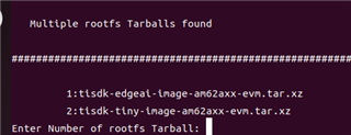

  Build an SD card using create sdcard.sh, but the serial port does not print logs.
   pleace help me to check.
Daohong
    Yes, I built the SD card using the create sdcard. sh method in the link, but the serial port does not print logs.
    Daohong
  • The log of./create sdcard.sh is as follows.

    	Choose file path to install from
    	1 ) Install pre-built images from SDK
    	2 ) Enter in custom boot and rootfs file paths
    Choose now [1/2] : 1
    Will now install from SDK pre-built images
    now installing:  ti-processor-sdk-linux-edgeai-am62axx-evm-09_01_00_07
       Multiple rootfs Tarballs found
    	 1:tisdk-edgeai-image-am62axx-evm.tar.xz
    	 2:tisdk-tiny-image-am62axx-evm.tar.xz
    Enter Number of rootfs Tarball: 1
    	Copying files now... will take minutes
    Copying boot partition
    Boot image not found
    tispl.bin copied
    u-boot.img copied
    uEnv.txt copied
    Copying rootfs System partition
    Syncing...
    Un-mount the partitions
    Remove created temp directories
    Operation Finished
  • If the commands are executed from withing the SDK directory, this should work, making sure the directory names or structure are unchanged.
    Just to confirm there is no hardware-based issue, could you please try out the balena-etcher tool to flash the default images into SD card and see if it boots.
