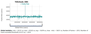

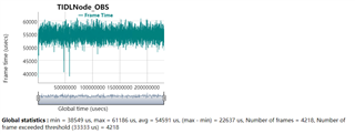

We used the same model, configuration, and program to run on TDA4VM (SDK8.0) and TDA4VE (SDK9.2) respectively (both TDA4VM and TDA4VE have 2G DDR), and found that the time spent on TDA4VE was nearly 20ms more than on TDA4VM. However, from the perspective of configuration, TDA4VE has an improvement in MMA compared to TDA4VM. But the actual test results are opposite, please help confirm the reason. Thankful.
here is the result of TDA4VM(SDK8.0)
here is the result of  TDA4VE(SDK9.2)

  • Hi Sam,
    From a hardware/datasheet spec perspective, I would not expect to see a significant performance drop between TDA4VM and TDA4VE. In both instances you would be running your model on 1 C7x+MMA core.
    From a software perspective, for the model you provided, to further debug - could you provide the inference with 8.0 SDK at debugTraceLevel = 1 and report back the layer level cycles? This can then be compared with the 9.2 values to see if there are any significant differences.
    Asha
  • Hi Asha,
    I have tested their model on tda4vm and ve with the model with edgeai-tidl-tools. In default settings, vm has more msmc than ve and indeed has better latency than ve. After setting the same msmc, ve is better than vm. So the customers' problem may just come from the msmc size.
    Adam
  • Hi Adam,
    Thank you for helping out with debug for this issue, I appreciate it.
    If the settings had TDA4VM using more MSMC space in the comparison TDA4VE, I would not be surprised if latency was higher for TDA4VE, assuming in this case that more DDR memory was used as a result.
    Can we close this thread as a result of your investigation? Then open a new one if experiencing difficulties with mixed precision.
