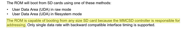

Part Number: AM6442
Is there any limitations for the sd card capacity supported? Can we use it with a 64Gb sd card ?
Thanks!

Hello Hans,
Similar to AM335x, the Linux MMC driver should not add any additional limitations. A 64Gb SD card should be fine.
https://e2e.ti.com/support/processors-group/processors/f/processors-forum/990686/am3358-maximum-capacity-for-emmc-on-mmc1/3661787#3661787
Nick
The ROM as well doesn't put any limitations as shown in the following snap from the TRM
