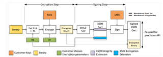

Referring to the following figure as described here https://software-dl.ti.com/tisci/esd/latest/6_topic_user_guides/secure_boot_signing.html
Are there 2 separate sets of keys being used for encryption?
I understand PKI, where they use both a public and private key and that is what I am assuming is being used in the figure.
I think that MPK and MEK are 2 different public keys and inside the AM64x, there are 2 different private keys or am I wrong and MEK is a private key.
This is the Public Key: MPK: Public Key
Is this the Private Key, or another Public Key: MEK: Manufacturer Encryption Key
Thank you,
  • The diagram is for code signing process by user to sign, and optionally encrypt binary blob.
    - (S)MPK is RSA key which is used to sign x.509 certificate for integrity check
    - (S)MEK is symmetric key which is used to encrypt binary blob for confidentiality protection.
