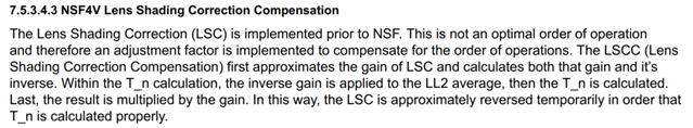

Recently I went through the chapter for VPAC in the TRM of AM62A, and here are some question I want to ask:
1. In 7.5.3.4.3, the lens shading correction compensation is added because the LSC is implemented prior to NSF. I don't quite get the idea here. I consulted some friends working on ISP flows, and they all said LSC should be prior to NF, as otherwise it would make the already uneven illumination more messy, thus affect the accuracy of shading correction.

  • Hi Jingjie,
    Yes, LSC is before NSF4.
    LSCC is needed because LSC is before NSF4.

  • Hi Gang,
    Please allow me to further explain the question:
    1. The first question is just me not understanding why putting LSC in the first is not optimal.
