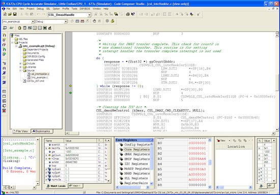

  • Let me clarify the problem again. The C6726  binary image generated with CCS 3.3 (version 3.3.82.2, Code Gen tools 6.0.8), when it has been loaded into SDRAM by the host processor boots out of SDRAM and runs fine. The same code generated with CCS 3.3 (version 3.3.82.13, Code Gen tools 6.1.20) does not.
    When I plug in an XDS510 USB JTag debugger into my board, and then single step thru my code, the bootloader successfully completes and branches to main( ). I then start calling CSL functions to configure the DMAs, McASPs, etc. The puzzling aspect is that the DSP code gets stuck at the EXACT SAME point inside the CSL_intcHookIsr routine, looping between addresses 80050F50 and 80050F60, regardless of which set of tools generated the code. In the case shown below, the code execution has trampolined from internal RAM to external SDRAM where the CSL *.lib routines are linked/stored.  I have modified the linked code so that the CSL *.lib routines are linked/stored into internal RAM as well, however, the code execution gets stuck in a loop at the exact same 4 assembly instructions.

  • Looking at the CSL source code, I believe it's waiting for DMA transfer to complete.
    It should eventually time out and exit the loop.
    Refer to file: csl_C672x_src_03_00_09_00\dsp\src\intc\csl_intcHookisr.c
                while (response--);
                 * Waiting for DMAX trasfer complete. This check for count0 in
                 * one dimentional transfer. This routine is for setting
                 * interupt handler the transfer complete interrupt is not used
                do {
                    response = *(Uint32 *) gpCount0Addr;
                } while (response != 0);
    Have you tried building, loading, and running the example project located here: csl_C672x_intc_03_00_09_00\dsp\examples\c672x\intc\src\ ?
    -Mark

  • Joe,
    I do not have a 6726 EVM board to try this out on, so I'm flying a little blind.
    I found a strange thing.
    I built the example intc project after making same changes you did. I loaded and ran the .out file on the 672x simulator. When I halted the program, it was in the do-- while() loop. I forced contents of address 0x620080A8 to be 0 so that it would exit the do..while() loop.
    Address 0x620080A8 is the DMAX register location that is being checked . It initially contains an 8 and the code should stay in the loop until the contents reaches 0.
    I found that it did not exit the loop after forcing the contents to 0.
    So then I tried adding the csl_intcHookIsr.c file to the project so that when I built the project, this file would be compiled instead of linking in the one from the library (I'm using CGT v6.1.20).
    I loaded and ran it and tested it the same way and found that it did exit the loop when I forced the DMAX reg (0x620080A8) to 0.
    Can you try doing this and running it on your h/w to see if it is able to get through the loop and let me know your results?
    Here's snapshot of disassembly while program is in do...while() loop. In this case, the project was built with the csl_intcHookIsr.c file added. As you can see, the disassembly is different than when project uses the csl_intcHookIsr from the CSL library.
    Mark
