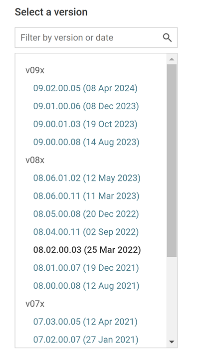

Can I get different Yocto versions release dates - past to present?
What is difference between meta-ti, tisdk, arago etc
Hi Anu,
Linux SDK base link: www.ti.com/.../
All the release versions:
You can find all the release related data under the release notes:
And so on....
You can find the U-Boot, Linux kernel, Yocto versions.
