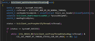

I am using the python script uart_uniflash.py to load the sbl_null bootloader into flash. Since after the upload of the sbl_uart_uniflash.release.hs_fs.tiimage, the progress bar stops, I have set a loop_forever function into the main.c of sbl_uart_uniflash example code.
Stepping through the code I found out, that it stays in the while-loop here
This is the called function inside Bootloader_socWaitForFWBoot() in main.c
How can this happen?
