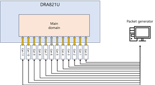

    The test configuration is as follows.
    Packet generator setting
    Bus load (93%)
    When tested with the above setting, "msglost in rxf0" occurs and CPU usage becomes 100%.
    Please let me know how to increase CAN traffic processing capacity.

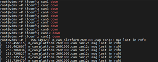

  • Hi
    When only 1 port out of 12 ports of CAN (CAN12) is enabled and RX, the same message occurs.

  • Hi Takuma,
      If refer Dohyeon's test diagram, it is not loopback test. It is similar with real usage case than loopback.
      Please test with Peak CAN, CANoe or Kvaser.
      Thanks for your support.
    YoungHan Kim

  • Hi Takuma
    In the environment I test, the interface setting is bitrate 500 kbps and dbitrate 2 Mbps.
    When transmitted at 1 Mbps (50%) in the packet generator, "m_can_platform 2691000.can11: msg lost in rxf0" log is generated.
    "m_can_platform 2691000.can11: msg lost in rxf0" occurs the same way when Takuma sets the environment, bitrate 2 Mbps, dbitrate 5 Mbps, and proceeds with the same test (1 Mbps).
    In addition, when the same traffic test (1 Mbps) was conducted after connecting 1 CAN interface, "m_can_platform 2691000.can11: msg lost in rxf0" did not occur.
    When testing with only 1 interface, "m_can_platform 2691000.can11: msg lost in rxf0" log is generated when the amount of traffic is raised to 1.8 Mbps (90%).
    Looking at the test contents, it seems that the debug log is output according to the amount of traffic.
    How much traffic bps is the loopback test?
    I want you to test it through the packet generator.
    Dohyeon

  • Hi Takuma
    I connected the CAN interface as below, and did a loopback test.
    The test using "canend" did not output the message "m_can_platform 2691000.can11: msg lost in rxf0".
    "cangen" can be used to replace the packet generator.
    When tested with "cangen" in the same configuration, a few minutes of waiting resulted in the output of the message "m_can_platform 2691000.can11: msg lost in rxf0".

    Maybe the key here is using traditional CAN vs CAN FD protocol. Can you also try with cangen with the -f option to confirm if this is seen on your board as well?
    Takuma
  • Hi Takuma
    Looking at the bus load graph, the difference is as follows.
    The issue now is not to verify the behavior of "cangen".
    When mounted on a car, the packet does not occur the same as "cangen". It was only used as an alternative to reproduce the symptoms.
    The point of the current issue is to analyze the issue regarding the occurrence of the message "m_can_platform 2691000.can11: msg lost in rxf0".
    Dohyeon.
  • Hi Dohyeon,
    Can you confirm that you can get a working CAN set up with cangen where "msg lost in rxf0" is never observed, so that we can use this as a reference to debug your usecase?
    I understand that the issue is not to verify the behavior of cangen, and we are only using it as a method to debug your original usecase.
    However, because the issue can be reproduced with cangen, and furthermore, fixed by changing the behavior of cangen, I propose we investigate this difference in behavior so that you can use the learnings to fix your original usecase.
    Where I am trying to go with these experiments is that if you set the exact same settings in your PCAN tool usecase as the working cangen usecase where the "msg lost in rxf0" does not occur, then the behavior should be the exact same and issue can be fixed.
    Takuma
  • Hi Takuma
    I took out the CAN FD and tested it as below.
    ip link set can10 txqueuelen 1000
    ip link set can10 up type can bitrate 500000 sample-point 0.80 restart-ms 300
    ip link set can11 txqueuelen 1000
    ip link set can11 up type can bitrate 500000 sample-point 0.80 restart-ms 300
    The same problem is reproduced.

    root@vdms:~# [  610.834511] m_can_platform 2691000.can can11: msg lost in rxf0
    [  610.837675] m_can_platform 2691000.can can11: msg lost in rxf0
    [  656.439162] m_can_platform 2691000.can can11: msg lost in rxf0
    [  656.443703] m_can_platform 2691000.can can11: msg lost in rxf0
    [  656.448094] m_can_platform 2691000.can can11: msg lost in rxf0
    [  656.537217] m_can_platform 2691000.can can11: msg lost in rxf0
    [  656.540685] m_can_platform 2691000.can can11: msg lost in rxf0

    Essentially, I configure mcu_mcan0 as CAN-FD with dbitrate of 2Mb/s and arbitration bitrate as 500Mb/s, and use it as a receiver. On the other hand, mcu_mcan1 is configured as a classical MCAN interface with bitrate of 500Mb/s and used as a sender.
    I've let it run some time, but no dropped packets yet.
    Lastly, connection looks like below. Just some jumper wires between J30 and J31.
    Takuma
  • Hi Takuma
    We use the main can interface.
    Please test using main_can0 and main_can2 in EVM
    Dohyeon
  • Hi Dohyeon,
    J7200 EVM is slightly strange for main CAN interface, so took some time... but I was able to do the same experiment with similar results (although, I did find an interesting thing that may or may not affect your board):
    1. main_mcan3 has issues due to mux-controller having the same name in dts file. Can be fixed with this patch:https://e2e.ti.com/cfs-file/__key/communityserver-discussions-components-files/791/0001_2D00_fixing_2D00_main_5F00_mcan3.patch
      However, issue is board specific and the error log is "m_can_platform 2731000.can main_mcan3: bus-off", which is different from how your board is failing
    2. main_mcan0 is routed to the SOM board instead of CPB board, so had to connect like below for main_mcan0 <-> main_mcan3 test:
    However, after those two learnings I do not see any errors. Logs below for reference:

    When we did the same test on EVMs we have, "m_can_platform 2701000.can0: msg lost in rxf0" log did not occur.
    Compared to Dasan-designed boards, DRA821 chip part-number is different.
    DASAN
    EVM
    In the case of Dasan-designed boards, when scaling_governor was set to performance, packet drop did not occur.
    Q1. Is there a difference between the CPU on EVMs and the CPU on Dasan designed boards?
    Q2. How does it affect internal behavior when setting scaling_governor to performance?
    Q3. Is there anything I should check if I set scaling_governor to performance on a regular basis?
    Dohyeon.
