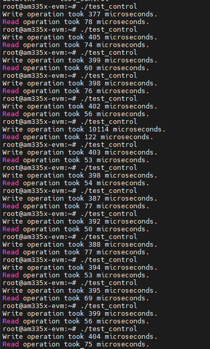

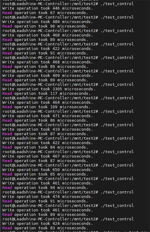

Hi, our company is currently having an issue with the read and write speeds of files on the am3352 platform across different kernel versions. In the 4.9 kernel, reading and writing files takes longer than in the 3.2 kernel(It's the same for NAND flash and SD cards.). Here are the specific details:
  • kernel version:we have two version 4.9.69 and 3.2.0
  • flash memory(Partitioning Format): nandflash(ubi), sd card(ext3, fat32)
  • Testing Methods: Write and read 400 bytes of data in the file.
  • We used the strace tool to capture the system call times.
  • test program, glibc library, and strace version are all the same.
        1. sd card(ext3)
        Time-consuming:
       4.9.69 version:                                                                                                    3.2.0 version:
      We used the strace tool to view the time spent on system calls:

     We found that the time taken for each system call in version 4.9 is higher than that in version 3.2. Why is this?
