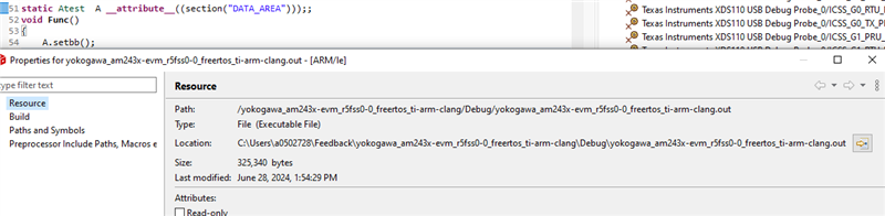

    I have tried to build the hello world cpp example with the above changes and not able to see the generated *.out file having size ~200M.
    The generated file has size of around ~317KB only.
    Please refer below screenshot.
    Can you please detailed steps for replicating issue at our end?

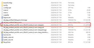

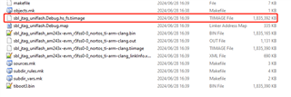

    And my bin file is like below
