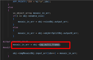

Hi experts,
SDK8.6
J721E EVM board
tda4-project/PDK0806_RTOS/vision_apps/apps/basic_demos/app_multi_cam/main.c
Only 1 camera output YUYV
1.yuyv - color_convert(NV12) -
display_in_image = obj->cvt_out_image;
Image display ok, just like I saved the image:
save-corver-image_0000.zip
2.yuyv- color_convert(NV12) -
obj->cvt_out_image = vxCreateImage(obj->context, DISPLAY_WIDTH, DISPLAY_HEIGHT, VX_DF_IMAGE_NV12);
obj->node_cvt = vxColorConvertNode(obj->graph, color_convert_in_image, obj->cvt_out_image);
obj->cap_multi_frames = vxCreateObjectArray(obj->context, (vx_reference)obj->cvt_out_image, obj->sensorObj.num_cameras_enabled);
ldc_in_arr = obj->cap_multi_frames;
display_in_image = obj->imgMosaicObj.output_image[0];
image display unusual. just like I saved the image:
save-mosaic-image_0001.zip
What modification did we miss? How to solve?
Looking forward to your reply.
Barry

  • Hi Nikhil,
    I am tda4-project/PDK0806_RTOS/vision_apps/apps/basic_demos/app_multi_cam/main.c
    1.
    ldc = 0 ,enable_mosaic = 0
    display ok just like save image save-corver-image_0000.zip .
    2.
    ldc = 0 ,enable_mosaic = 1
     display unusual just like save image save-mosaic-image_0001.zip .
    Our changes in app_multi_cam/main.c are shown in the screenshot, What did we miss? How to solve?
    Barry

  • Hi Nikhil,
    1.Your understanding is correct.
    vxColorConvertNode output save image OK:save-corver-image_0000.zip
    Mosaic output save image not OK:save-mosaic-image_0001.zip
    2.The problem lies in the assignment of mosaic_in_arr. What actions do we need to take between vxColorConvertNode and mosaic_in_arr?
    Here is what we have done now (mosaic output image is abnormal):
    status = vxSetNodeTarget(obj->node_cvt, VX_TARGET_STRING, TIVX_TARGET_DSP1);
    status = tivxSetNodeParameterNumBufByIndex(obj->node_cvt, 1u, CAPTURE_BUFFER_Q_DEPTH);
    mosaic_in_arr = obj->cap_multi_frames;
    Looking forward to reply.
    Barry

  • Hi Nikhil,
    We use tda4-project/PDK0806_RTOS/vision_apps/apps/basic_demos/app_multi_cam/main.c
    Our modifications in main.c are only the following, so what modifications do we need to add?
    //mosaic_in_arr = obj->objArrSplitObj.output0_arr;      //disable
    mosaic_in_arr = obj->cap_multi_frames;  //enable
    1.We did not modify the configuration of the mosaic node.
    2.camera output  YUYV, I understand that LDC doesn't support its input, right?
    Barry

  • Hi Nikhil,
    1)When we set it up like this:
    color_convert_in_image = (vx_image)vxGetObjectArrayItem((vx_object_array)mosaic_in_arr, 0);
    or
    color_convert_in_image = (vx_image)vxGetObjectArrayItem((vx_object_array)obj->objArrSplitObj.output0_arr, 0);
    The error is as follows:
    Capture graph done!
    21814.482181 s: VX_ZONE_ERROR:[vxGetObjectArrayItem:207] Provided reference was not an object array, returning an error reference
    21814.482246 s: VX_ZONE_ERROR:[vxSetParameterByIndex:239] Invalid type 0x00000811!
    21814.482254 s: VX_ZONE_ERROR:[vxSetParameterByIndex:287] Specified: parameter[0] type:00000811 => 0xffffb12d7838
    21814.482260 s: VX_ZONE_ERROR:[vxSetParameterByIndex:289] Required: parameter[0] dir:0 type:0000080f
    21814.482318 s: VX_ZONE_ERROR:[vxSetReferenceName:646] Invalid reference
    create convert color node return status: -12
    vxColorConvertNode output type is vx_image
    So can you tell us what we need to do in between? Looking forward to your reply.
    mosaic_in_arr input type is vx_object_array
    2)
    2.By the way, when we use M2M node instead of vxColorConvertNode, the mosaic output is OK.
    Barry
