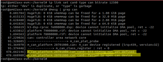

We have started working on the MCAN module configuration for the AM62A7 Development Board。SDK version is 09_01_00.
We have done the following:
1. enable can driver in kernel.
2. config main_can0 and gpio in DTS.
After build SDK and flash to our board, we check it with some error:
1> "ifconfig" -----> not find can0 device
2> "ifocnfig -a" ---->find can0 device
3> "ip link set can0 type can bitrate 12500"
error info: "ip: either "dev" is duplicate, or "type" is garbage"
4. "ip link set can0 up"
error info : "ip: SIOCSIFFLAGS: Invalid argument"
so how to config mcan module correctlly?
I would appreciate your advice on this particular matter.
thanks.

    And we meet a problem: if we turn on the "#phy-cells = <0>;" configuration, it failed in registering the CAN0 device.
    // m_can_platform.c
    	transceiver = devm_phy_optional_get(&pdev->dev, NULL);
    	if (IS_ERR(transceiver)) {
    		ret = PTR_ERR(transceiver);
    		dev_err_probe(&pdev->dev, ret, "failed to get phy\n");
    		goto probe_fail;
    dmesg infoormation
    [   65.107589] ----------------------> m_can_plat_probe
    [   65.113069] ----------------------> devm_platform_ioremap_resource_byname()
    [   65.120228] ----------------------> platform_get_irq_byname(): irp = 439
    [   65.126949] ----------------------> platform_get_resource_byname()
    [   65.133160] ----------------------> devm_ioremap()
    [   65.137964] ----------------------> failed to get phy: ret = -517
