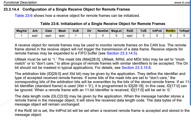

AM3352: How to configure a Single Receive Object for Remote Frames about CAN of AM3352
Part Number: AM3352

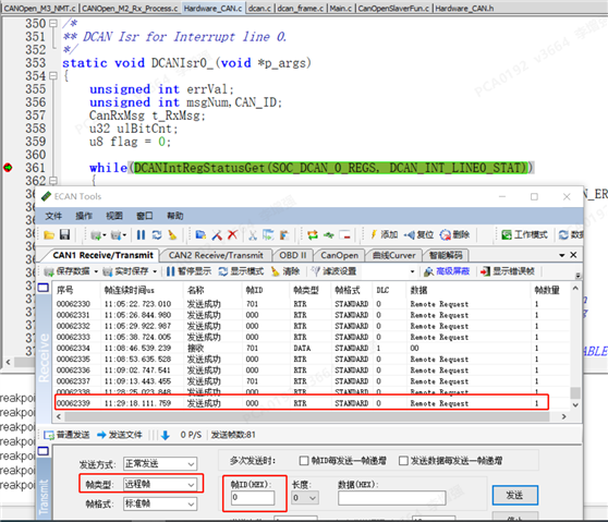

I use CAN of AM3352 and want to receive of Remote Frames,but I do not know how to configure receive message object。Currently, I have done the following test.
t_entry.flag = (CAN_DATA_FRAME | CAN_MSG_DIR_RX);//rxflag msgnum = 32;
t_entry.id = 0x701;//CAN_RX_HEART_CMD;
t_entry.mskid = 0x780;//CAN_RX_MSK_CMD;
CANRxObjectConfig(SOC_DCAN_0_REGS, &t_entry);
t_entry.flag = (CAN_DATA_FRAME | CAN_MSG_DIR_RX);//rxflag msgnum = 33;
t_entry.id = 0x00;//CAN_RX_NMT_CMD;

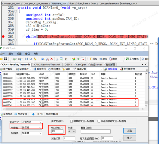

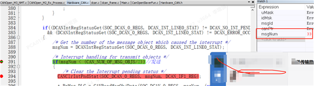

the result of testing is following:
when Sending the remote frame CANID is 0x00,I can receive the remote frame and the msgNum is 33,but when Sending the remote frame CANID is 0x701,I can not receive the remote frame.
