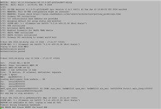

  • Since there is no error provided in the log - I'm guessing there is a power issue of some kind.   Can you try removing and re-installing the small processor board?  Maybe its not making good connection.
  • Hi Robert,
    We tried removing and re-installing and came across to new errors while trying to boot device. these logs are attached below.
    - Rishad
  • Again - it looks like the board is not making good connection.  Can you try re-seating a few times?
  • When using another sd card with a previous version the board got booted up. But CSI ports are not detecting cameras connected. cameras we're using are IMX219.
    - Rishad
