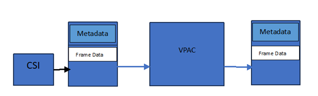

After we receive the camera frame at CSI, Is there a provision to pass the metadata (Frame count, checksum) along with the frame through VPAC block after preprocessing the data to application.

Hi Rajesh,
No VPAC cannot pass on the metadata at the output.
