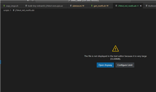

and even we use the tisdk-tiny-image-j784s4-evm.tar.xz to make the ubi the image still more than 53MB,is there any choice for less flash size using?
