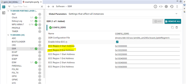

I am testing the DDR ECC Test MAIN ESM example on SK-AM64B. In the example.syscfg file, there is some configuration done for DDR memory.

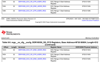

In this configuration the ECC protection start and end address is mentioned. But if I refer to MEMORY MAP page then the address range of DDR is different then the
one mentioned in the syscfg.
a. Can you please help me understanding how this address is range is defined?
b. As per configuration, I can only program 3 address ranges for ECC protection. Is this understanding correct?
