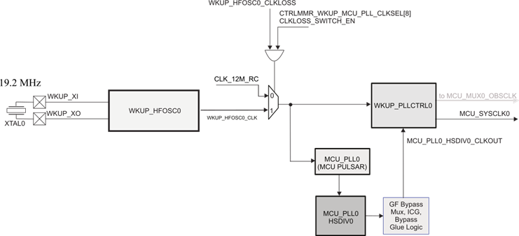

based on our understanding form Technical Documentation, the 19.2 MHz is selected. As my understanding from TI, that the WKUP_HFOSC0, MCU_PLL0 and WKUP_PLL_CTRL0 is done by ROM code at begin(R5 first PLL lock by DMSC). After boot up, it can not be changed, even register of those PLL has description. Then what is the output freq. of MCU_SYSCLK0?

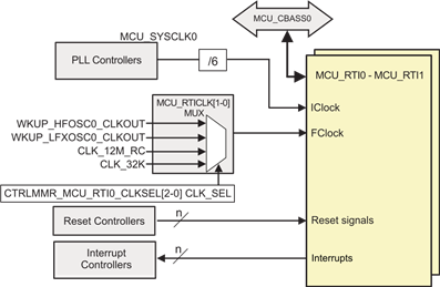

After MCU_SYSCLK0 is confirmed, then to the WDG in MCU Domain.(RTI).  As my understanding the Functional Clock is used for the setting of the watchdog time.  Interface Clock --> what is usage? For the MCAL config. which freq. of the clock has impact to the configuration?
WdgRtiFrequency is default with 12.5MHz (internal CLK_12M_RC)?  this freqency setting is based on which clock? also for later GPT timer. How does the clock impact those configuration (principal)?
    MCU_SYSCLK0 is 1000MHz clock. It is fixed.
    Which is given from MCU_SYSCLK0/6 for the watchdog peripheral internal operation.
    FCLK: Is functional clock, used to drive the counter of the timer module which can be configured using Configurator.
    Fclk is the one selection for watchdog counters from MCAL configuration.
    which can be 12.5MHz (CLK_12M_RC) / HFOSC0_CLKOUT (192.MHz) / LFXOSC0_CLKOUT (32.768KHz) /  CLK_32 (32KHz)
    12.5MHz is internal clock.
    You can change the functional clock used to driver the counters, and accordingly you need to configure the counters as per the clock selected.
    Z.Xia: That means IClock is not interested for user, as it is for internal operation? Functional clock is selectable in EB tool?
    Z.Xia: this means no matter  different external Osci. is selected, the ROM code will adapt it with setting of PLL Registers to reach output MCU_SYSCLK0 to 1 GHz (1000MHz)?
    Yes, It is fixed and 1000MHz. As per input HFOSC clock PLL will be tuned for 1000MHz output.
    Yes. customer no need to interest in this. Also, it is not configurable.
    as it is just WdgRtiFrequency can be configured.
    Yes, Which is configurable from EB tool.
    Z.Xia: ok, then it is ROM code to grantee that the SYS CLK. That means if we select 20MHz or other Oscillator, still the same output?

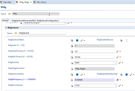

    Z.Xia, how to select the mux clock in EB tool between
    , looks like no items can be selected. screenshot?
    The motivation is to understand why default with 12500000? What is this freq. mean? Or here even 1000000 can also be configured. The MCAL code generation will be adapted to select the corresponded mux clock?
    Yes.
    Yes, EB Tool not having option to select the rtifrequency. The WdgRtiFrequecy is not using in configuration output.
    WdgRti Clock is configured form startup.c file. If you want to change the clock source you have to change from Startup.c file.

  • HI,
    WdgRtiFreqency is not defined in Autosar 4.3 version. why is appeared here? what is the use case of this parameter?

    you mean this WdgRti clock is only selectable in startup.c file, with followed options, but irrelevant to WdgRtiFrequecy  in EB tool?
    There is no use of that parameter. You can ignore it.
    It has to be taken care in application.
    The reference example from TI, configuring in startup.c file.
