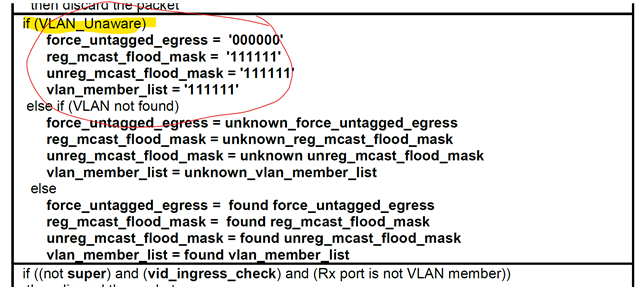

    From Ingress Filtering and Lookup processes in TRM it will accept all multicast & Broadcast packets.
    12.2.2.4.6.1.17.1 Ingress Filtering Process
    12.2.2.4.6.1.17.1 lookup Process
    Let me confirm once with IP team and update you.
    Sudheer
    Can you configure ALE in VLAN Aware mode in below and check whether you are receiving Multicast & Broadcast packet?
    aleCfg->vlanCfg.aleVlanAwareMode = BTRUE;
    Sudheer

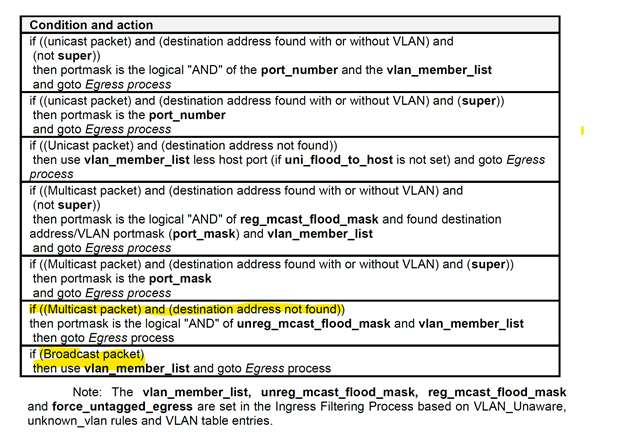

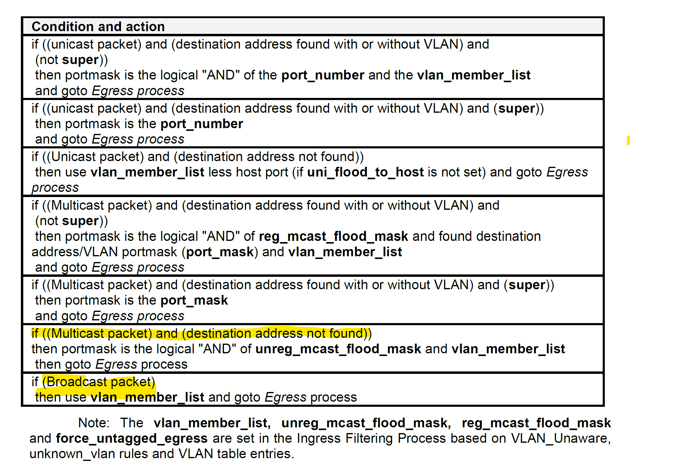

  • Hi Sudheer,
    If I use ALE_VLAN_AWARE: ENABLE, and change the following:
                    * Set UVLAN_MEMBER_LIST of CPSW_ALE_UVLAN_MEMBER Register to 3
                    * Set UVLAN_UNREG_MCAST_FLOOD_MASK of CPSW_ALE_UVLAN_URCAST Register to 0
                    * Set UVLAN_REG_MCAST_FLOOD_MASK of CPSW_ALE_UVLAN_RMCAST Register to 1
    I can filter the multicast ethernet packets based on ALE Look Up Table but still I am receiving broadcast ethernet packets, although broadcast MAC address is not in the ALE Look Up table.
    The open questions are still need to be clarified:
    1. WhyCPSW2G is receiving broadcasted and multicast ethernet packets when ALE only have 1 unicast entry in Lookup Table?
    2. How can I block these unwanted broadcast and multicast ethernet packets in ALE_VLAN_AWARE: DISABLE?
    Hasan
    Yes, as per your configuration Multicast will be filtered where as Broadcast will accept.
    Please refer to Lookup Process.
    It is because VLAN AWARE is disabled.
    As per below unknown VLAN values will make Broadcast & Multicast to reach to Host Port.
    It May not be possible with VLAN AWARE DISBALE.

    Have you checked, Unicast packets are dropped when " UVLAN_MEMBER_LIST -> 0" ?
    Sudheer
  • Hi Sudheer,
    Yes, I have checked unicast packets are dropped in this case.
    Hasan
    If so, you have to keep UVLAN_MEMBER_LIST as 3.
    It will accept the Broadcast frames.
    If you want to avoid the Broadcast you may need to Add ALE entry, also need to enable policer classification & forward to different flow which is not mapped to any Descriptors. It will drop all Broadcast packets.
    Or you can check in S/W and discard the packet based on need or not?
    May I know why you don't want Broadcast to be received at all? May I know use-case.

    Yes, you may block by adding ALE entry with port mask as zero.
    CPSW_ALE_TBLW2 = 0x00000002;
    CPSW_ALE_TBLW1 = 0x1000FFFF;
    CPSW_ALE_TBLW0 = 0xFFFFFF;
    Correct me if my understanding is wrong: In his case an entry is made into the ALE table considering the MAC address is unicast and is blocked.
    Instead of writing ALE registers, Use Enet IOCTL for addition of Broadcast MAC as in enet examples.
    User Port Mask as Zeros & secure bit set to 1.
    It will block Broadcast as ALE Drop as port_mask is 0.

    I have the following values of registers while transmitting unreg multicast:
    CPSW_ALE_UVLAN_MEMBER 00000003 UVLAN_MEMBER_LIST 3
    CPSW_ALE_UVLAN_URCAST 00000003 UVLAN_UNREG_MCAST_FLOOD_MASK 3
    Do I have to make an entry for this unreg multicast in the ALE table before transmission and then delete the entry after the transmision is complete? If not,
    what is the normal procedure to transmit unreg multicast ethernet packets?
    Above will allow unregister Multicast packet without ALE.
    You suppose to keep "CPSW_ALE_UVLAN_URCAST to 0" if you don't want unregistered to be allowed.
    You have to add ALE entry for any Multicast to be allowed/transmit. Then it will become known multicast entry.

    Sudheer: You have to add ALE entry for any Multicast to be allowed/transmit. Then it will become known multicast entry.
    Is this the normal procedure to transmit to unreg Multicast destination?
    Yes, As it is CPSW2G you can't flood anywhere other than Host Port.
    As you don't unknown multi to reach Host I recommended to make "CPSW_ALE_UVLAN_URCAST to 0" . Then only Known entries will be accepted.
    If you want to handle any, need to add ALE entry for the same.
    Its all depends on the use-case. How we want out system where to accept all multicast or only registered one.

    How does CPSW_ALE_UVLAN_MEMBER is used in case of unicast, unknown unreg multicast, unknown reg multicast and broadcast?
    Please refer to lookup process.
    Unicast & Broadcast will use "CPSW_ALE_UVLAN_MEMBER", where as Multicast will use mcast_mask AND member list.
    CPSW_ALE_UVLAN_MEMBER can be 0x3 (Host & External Port) or 0x1 (Host Port)  or 0x0 (No port is member for unknown VLAN , it will drop unknown)

    Question 1: Based on the question asked about broadcast ethernet packet that CPSW2G receives all the broadcast ethernet packets even through there is not ALE entry for Broadcast ethernet packets, does TI have plans to update TRM in future ?
    Question 2: Does TI also have plans to include more information about MAC filtering in ALE_VLAN_AWARE: Disabled?
    Above will be already addressed in TRM under Ingress Process, Lookup process.
    Above captures are from TRM only.
    Sudheer
